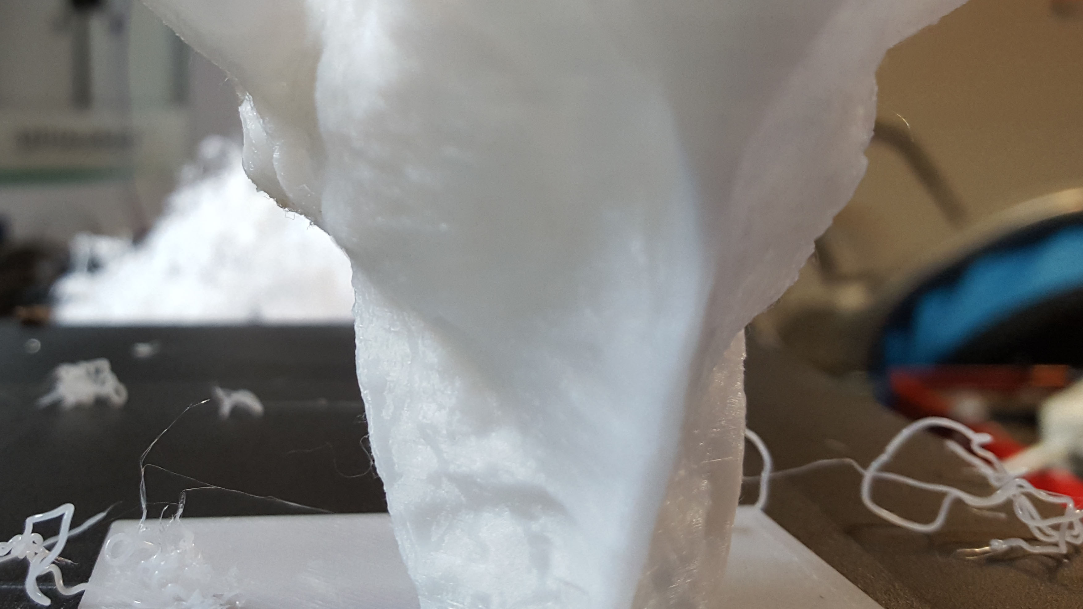

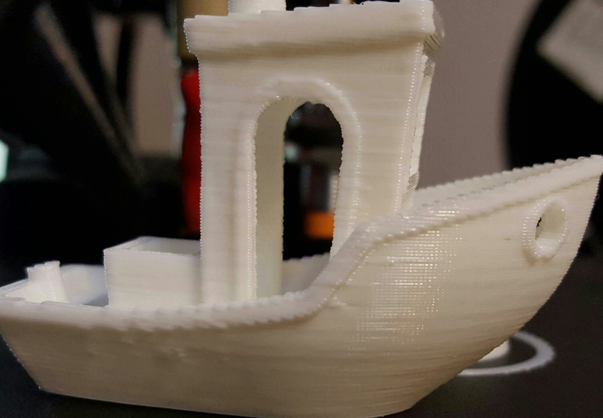

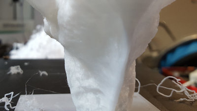

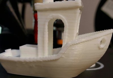

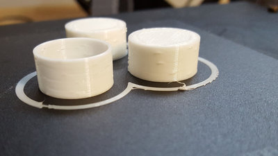

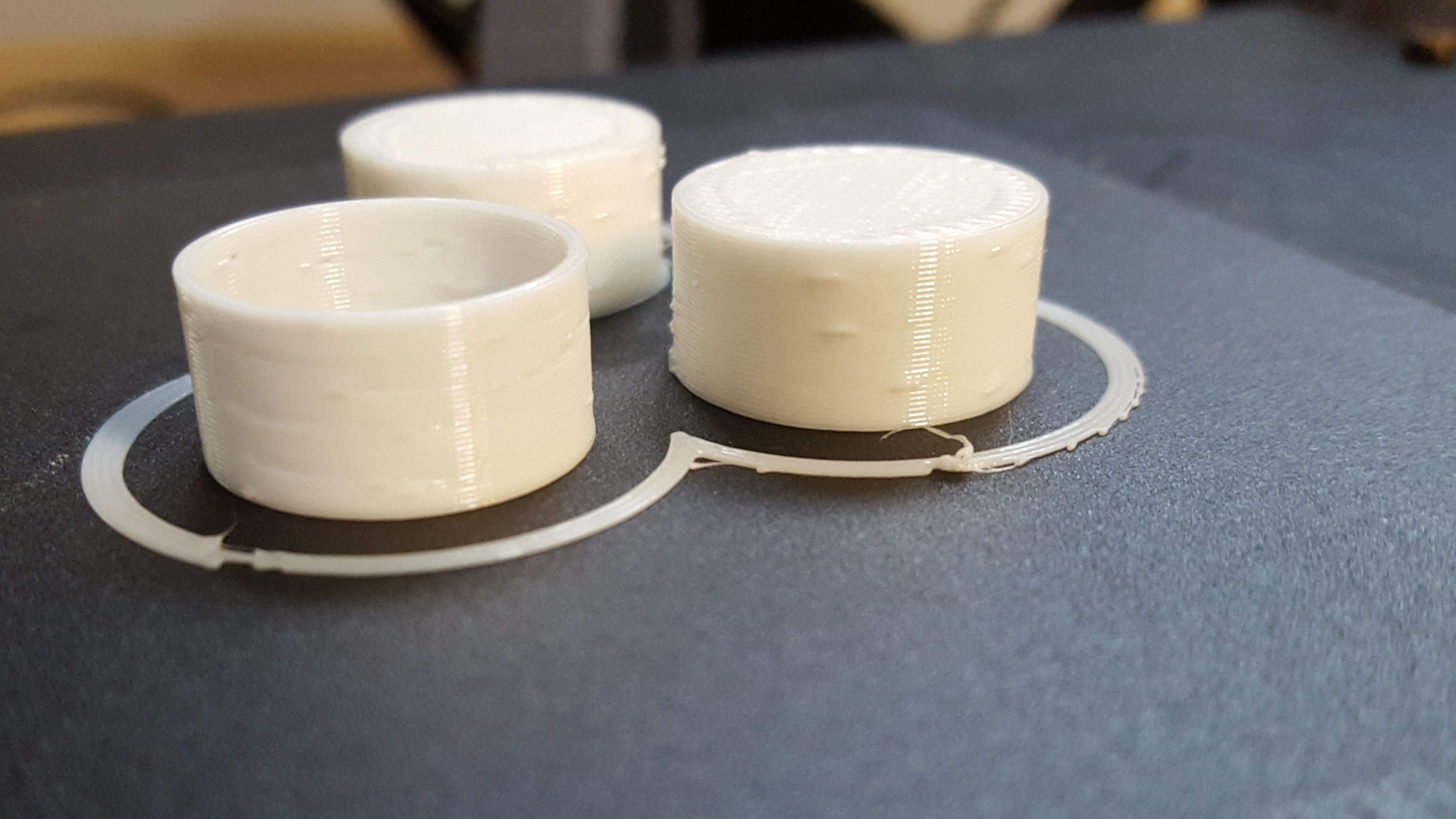

I am having a hard time getting rid of zits and blobs on the surface of my prints so I thought I'd reach out for help.
I'm printing on a Printrbot metal simple with PLA. I've calculated my Esteps, measured my filament diameter and printed solid 20x20 mm cubes to dial in my extrusion multiplier. So with that info and starting with the default metal simple profile I've been printing test print after test print without any improvement.
To eliminate the blobs I've set my retraction settings to 1mm retraction, 80 mm/s speed. I've tried combos of coasting, wiping, negative restart distances... nothing seems to help. Printing at 210 C ar .3mm layer height for now.
I've tried a few different filaments as well and I get the same results for each one. When I first got my printer I was getting great results with a half spool of white from printrbot but ran out and had some hardware issues. I've replaced both of my gt2 belts as one snapped and the other wore out in the center. I've tried 2 metal ubis hot ends but they both jammed so I sent them back.
I know the printer can do nice prints, I just have had nothing but bad luck with mine. Any ideas or suggestions would be appreciated.
