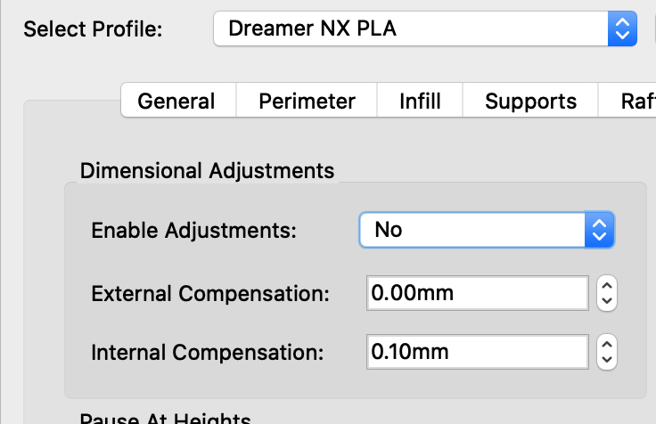

Hello,
I use a FF Dreamer but I really like the flexibility of S3D, however I cannot find a way to do this on S3D. The screen is from FlashPrint:
What it does is to adjust the dimmension variations for external and internal parts. For example a cube with a hole in the middle.
How do I do this with S3D? I tried Horizontal dimmesion but does not seem to take care of the internal size.

Thanks,
Yes I had a look at both, I just cannot get my head around why having an internal and external compensation (but seems to work) as all should be the shame. Trying on S3D and I'm not getting the same results.... anyway, I'll keep trying.

Ok, I tried with scale and horizontal correction. The results are very similar:
I'm ok getting the external size to 20mm by 20mm but the internal hole size that should be 10mm is always a bit smaller, about 9.5mm.
Any idea how to correct that? I attach simple STL (20x20x20mm with 10mm diameter hole in the middle)
Any advice would be great!
