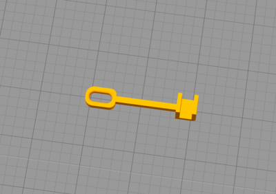

Hi! It looks like I am setting something wrong, but I can not figure out what. I have hole in model, but when sliced it shows the bridge. But let`s the pictures talk. :)

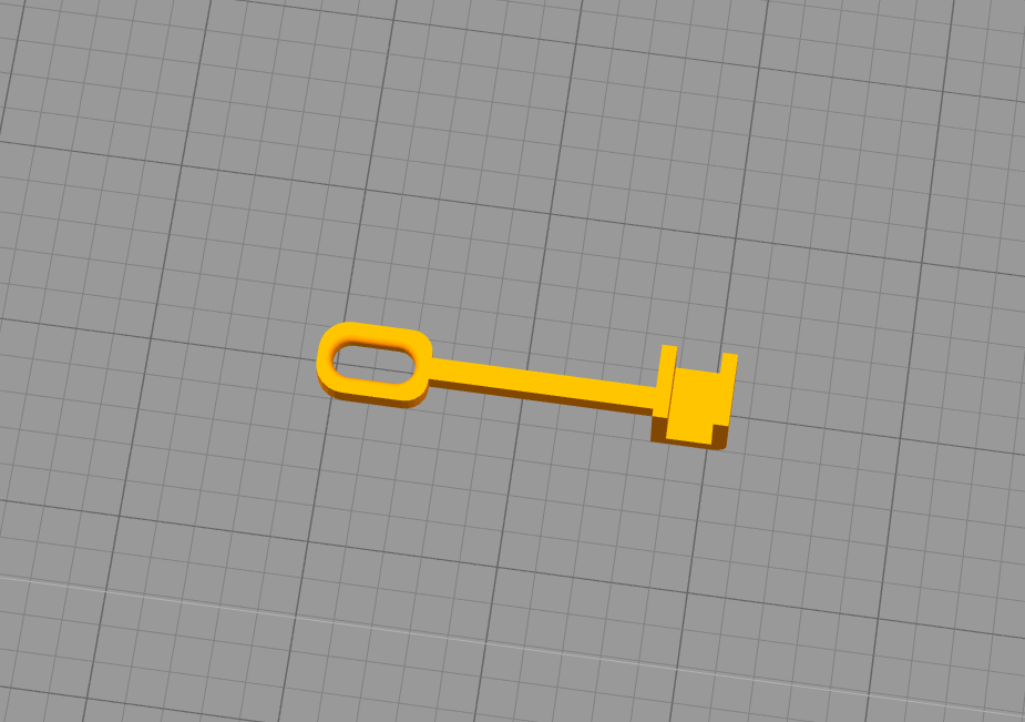

The model itself after Netfabb
(45.39 KiB) Downloaded 492 times
Before slicing:
My model
My model

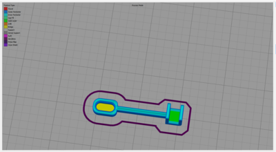

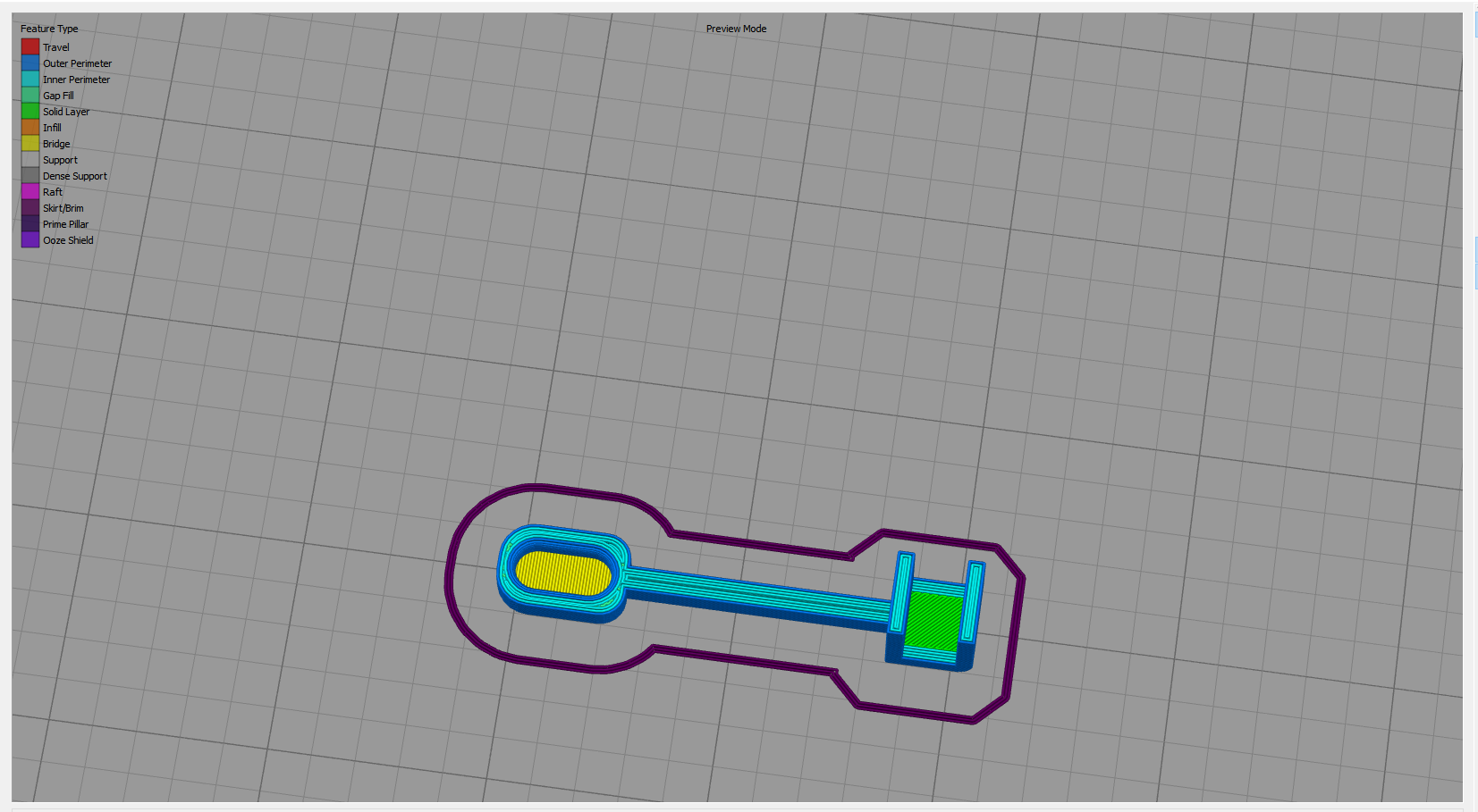

After slicing:
Sliced model
Sliced model

I have been having this same issue since v3 came out. No matter how clean and simple you build an item, it wants to put in a single layer bridge somewhere. I will also sometimes get very strange infills and areas that will not print at all. Files that had no problem running in V2 now do not print correctly in V3.

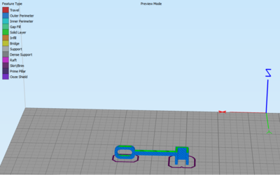

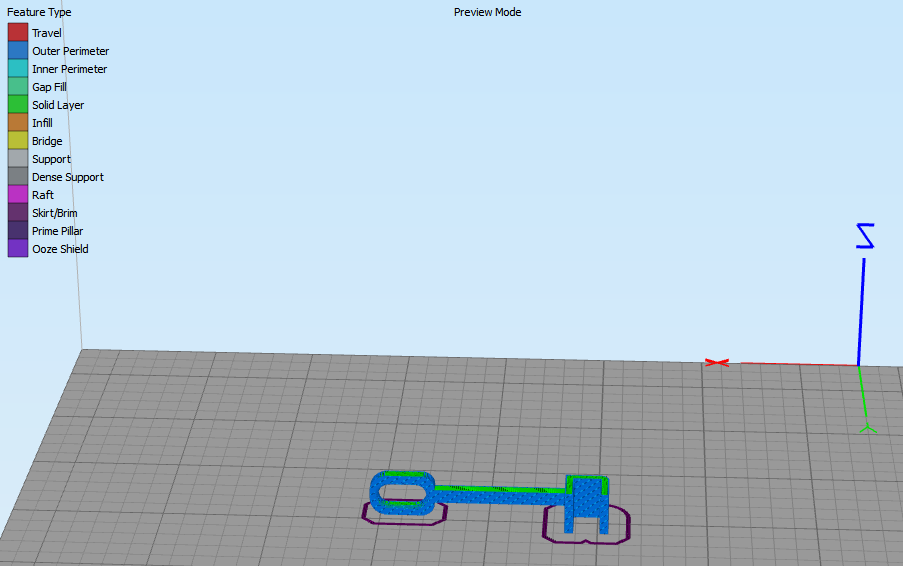

Ok. It must not be a file problem. It is bug in software. When I turn the object 90deg. Problem is gone.
turned 90deg and Sliced

I was able to find a workaround for the problem. Try changing the layer height. I went from 0.20mm layer height (with mystery bridging and VERY ruined print in the preview) to 0.25mm (with no mystery bridging).
That, paired with your angle change should make it pretty evident that it is not a modeling issue. Something in the S3D processing is causing hiccups.
