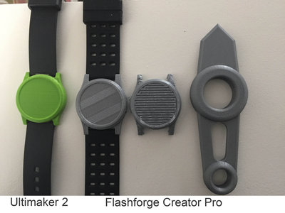

I was wondering if there was something that I can import to get the highest quality prints from PLA with a Flash Forge Creator Pro?
I tried to search around with no luck. I have tried a bunch of different prints but can't seem to get great results. I slowed my print speed down and the prints got worse.. Hmm
Not sure what settings would give me the (smoothest) look. I'm trying to print out Wrist Watch designs if that helps...
Thanks a million and apologies in advance if I'm overlooking something obvious.
I printed a couple Knife test prints that came out okay but my watches don't come out great... Same settings and I designed them both in SolidWorks

Green is a co-workers ultimaker 2 (face is smooth) - all the silver is my flashforge , the middle one I slowed down print speed and it was a mess. The knife came out better than all my watches using same settings,

One of those looks like it was printed vertically, while the other was printed horizontally. That's going to make a huge difference. And besides that, it's a little too blurry to tell much else.

Yup, the 2 objects look like they were printed in different orientations. Your second silver watch looks like you have it printing face down with support material. I wouldn't expect the face to come out smooth like that. You'd get a smoother face printing it upright with the support material and the ugly edge being on the inside of the watch, or like your coworker printing it standing up.

I will try switching the orientation of the print and see if that helps out.

giantpune wrote:You'd get a smoother face printing it upright with the support material and the ugly edge being on the inside of the watch,
This worked! Thanks so much I really do appreciate it !!!! I didn't clean it up or sand it down and it looks muuuuch better than before :)
