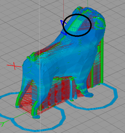

Start of layer speed?? (retract when crossing open spaces)
How come the start of my layers appears to print faster when I uncheck "Only retract when crossing open spaces"? When I have it checked, only the area behind the head has the faster speed. The start of the layer is a lighter color, is it printing faster?
Re: Start of layer speed?? (retract when crossing open space
Those look like wiping movements to me. If you turn off wiping, I'm guessing those will disappear.
