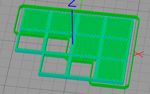

So i try to print this dual extrusion style and I get this:
Ooh, that ain't right. Some square missing, others only the outline, no infill, and the ooze wall is totally confused.
I try to fix the model, and it looks like a lot of the corners have been merged, which makes them technically non-manifold. So i create a new one by duplicating the sqaures and not merging the corners and I get:
Wait, that's not what I got last time. last time I got them all but the one in the middle. I mean this was closer, but that was closer still. Ah well.
I tried it with a 0.000001 gap between them. It turned out... better?
Listen, this is straight messed up. I should not have to go back to RepG to get my dual extrusion on.

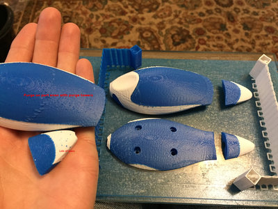

dennisjm
Posts: 343
Re: Dual Extrusion wizard doesn't like checkerboards
S3D printed in my hand.
* purge bumps.
- Get these even with a purge tower. Can't configure manual purge towers to save me.
- specs. Some say adjust tool change retract settings but I have no luck with this. I've tried lots of settings, with negative restart distance etc. Part of the problem is that each extruder needs it's own settings but the processes don't really allow different settings per extruder unless you start using multiple processes which then has it's own host of issues with dual prints.
On the makerbot printed parts on the tray you can see I don't get any bumps and the specs are much much reduced. This particular print is the first I printed with this filament from makerbot. The white is particularly over extruded and the blue is a bit over extruded too. Other than that I just popped it and and hit print. I suspect if I go back and tune the white filament extrude rate I'll get near the result I'm looking for.
