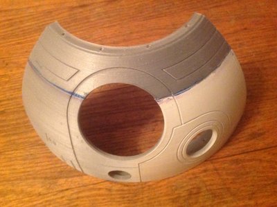

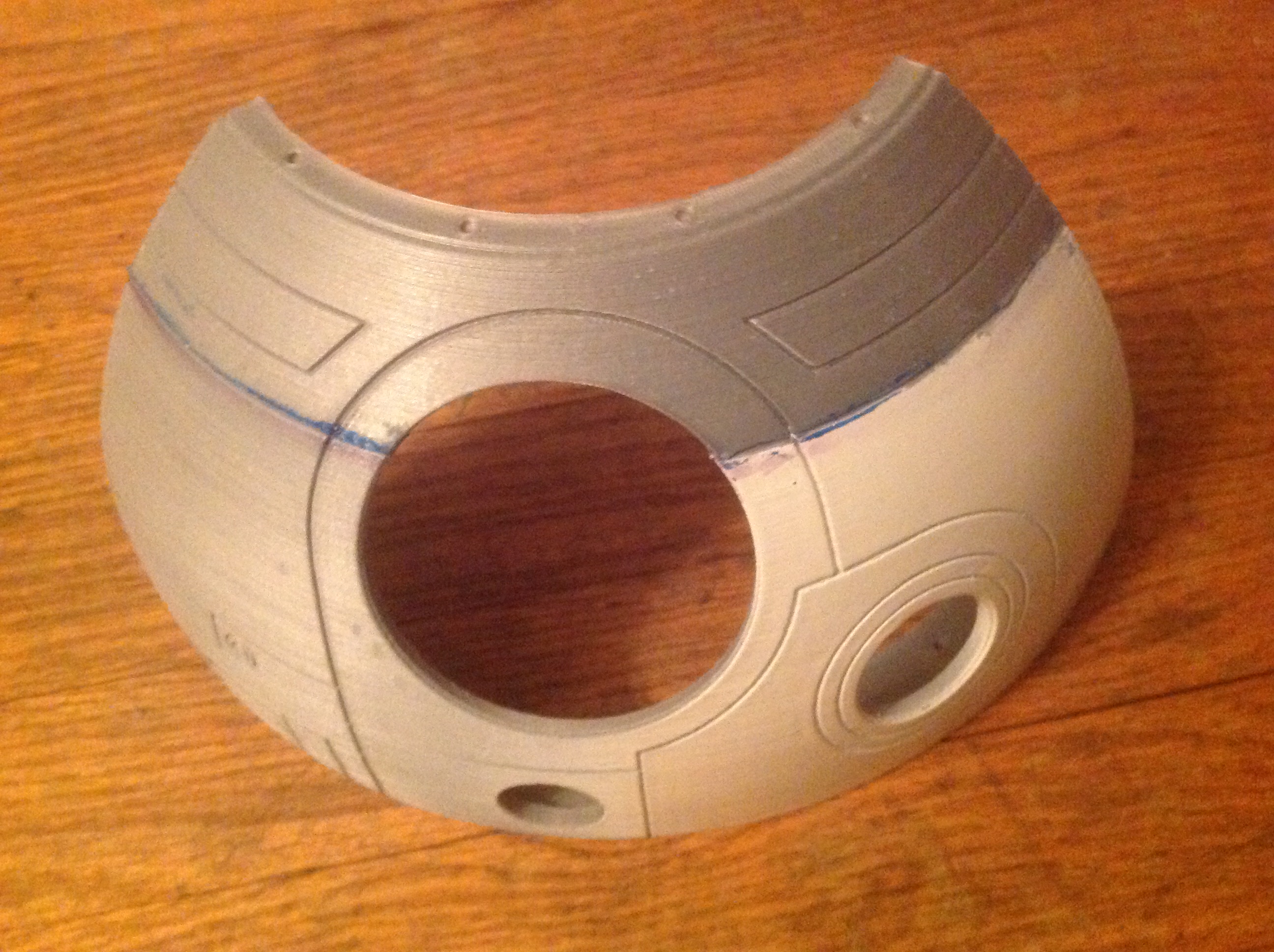

It worked! Awesome, I saved some pla.
I took your advice.
I put the failed print on the bed, Used the control panel n simplify to show me the hight. I then printed the rest. Glued, and it is a perfect match.
