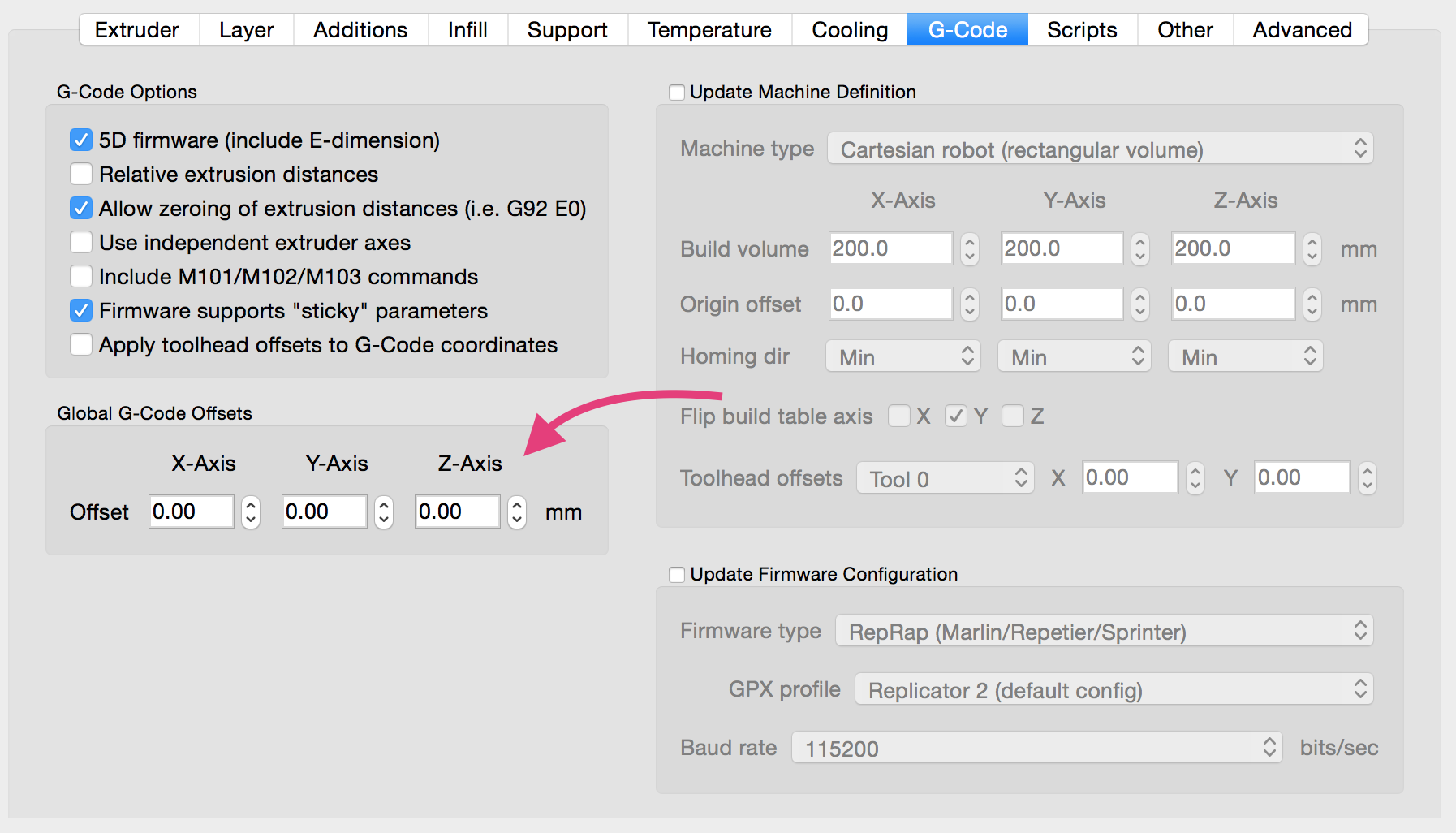

You can increase your nozzle height with a quick setting adjustment in Simplify3D. Inside the G-Code tab they have given us the ability to adjust the entire print's coordinates without adjusting the machine's conceived boundaries. This area of settings is titled Global G-Code Offsets.
To raise the nozzle all you would need to do is enter a positive amount in the Z axis entry field. Setting's location is pictured below.

I would recommend you try adjusting the nozzle height via the global Z axis adjustment....and if this doesn't help then post your factory file so we can take a look at what your current settings are...and advise what changes to try.
