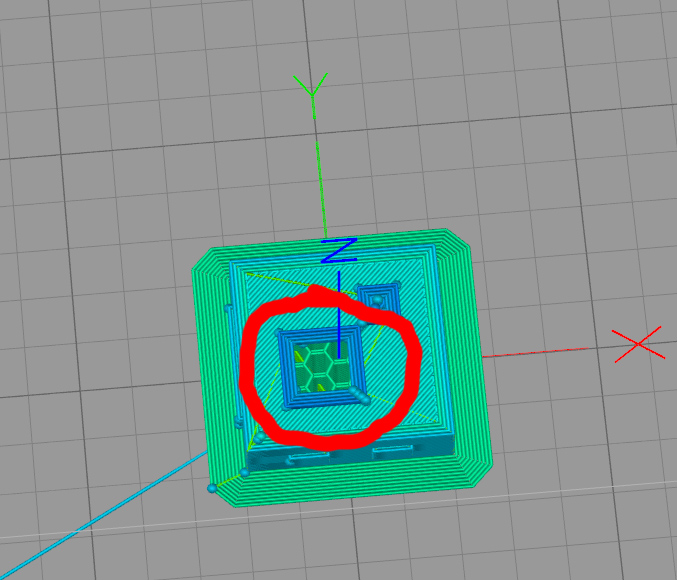

It does not print the top layer. 3.0.2

Re: It does not print the top layer. 3.0.2
Here is a the repaired files. If you run Windows 10, you can repair your 3D files with windows 3D builder.
There is an error in the model. If you run it through Netfabb Basic's automatic repair, it will correct it and allow it to print properly.
