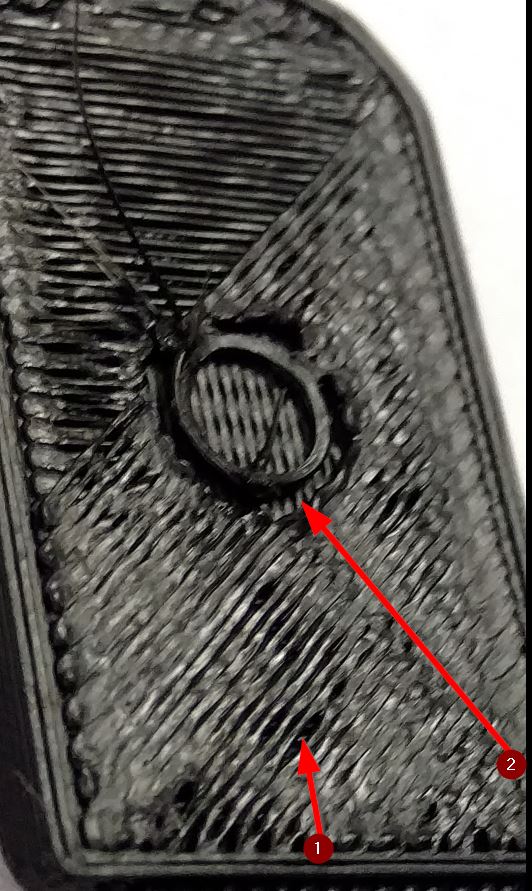

Ok. I think #1, in the photo, is under extrusion. I tried increasing the extrusion multiplier to 1.1 but that did not help. Is that right? I'm getting gaps between outlines and layer set to 100%. See #2. How to eliminate #2?
Thanks

Found it. https://www.simplify3d.com/support/prin ... nd-outline .
Can't believe I missed this the first time around.
