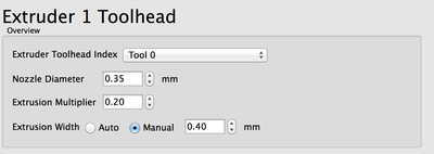

I've slowed the print speed, increased the fan, lowered the temperature. I've also been trying to play with the Extrusion Multiplier but to no success.
I've attached screen shots of my settings and a pic of the parts.
Any more ideas? thanks guys!

Yes--Simplify3D does not directly support "BFB" printers. It was made to work in a nominal fashion thru the hard work of many in this forum. The extrusion rate is set in the startup script (or other scripts) with the M108 SXX command, and is constant until another M108 command is issued. Simplify will not automatically issue this. More modern 3D printer firmware can adjust the extrusion rate automatically based on move speed. Sadly, this beast cannot.
your choice is to either manually insert the command into the BFB file before you encode it, or just print multiples of small parts. (I use this technique all the time--even on other much more capable printers)
FYI--the extrusion rate setting has no effect for this printer. Only the M108 command in the scripts has an effect on extrusion rate.
