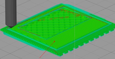

But I just want to understand some "why nots" better:
- Why the first layer is not 45 degree? it is like 20 degree as shown in the attachment 1.jpg.
- Is it possible to get the first layer above the support a little less than 1 layer? The problem I am having right now is PLA is kind of floating on the support coming out of the extruder because of the full layer skipped. I think 0.8 or 0.75 layer is enough to have fairly good separation, plus to have better contact with the first layer.
factory file and STL file are attached.
PS. I have almost OK result, but trying to see if anybody has mastered support with single extruder.

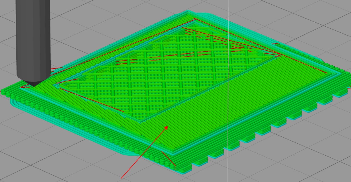

Re: First Layer above the support
It looks like it's doing bridging on that top layer (which would make sense since it's a big layer with nothing below it). You can turn that off by going to the Other tab and setting the bridging area threshold to 9999.
You are right! Thank you!
I did more research online. It looks like the support S3D is doing with single extruder is what the best it can do.
