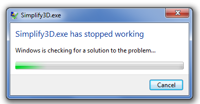

I have installed Simplify 3D on a Window's 7 computer 64 bit system. Installation works fine after logging in with user name and password the software does not start. From that point on each time I try to start it I get the error, "Simpify 3D has stopped working, windows is looking for a solution" then it changes to I will be notified when a solution is found. I have tried both 64 and 32 bit installations and bot react the same way.

All it says is that Simplify 3D has stopped working , then it says it is looking for a solution.
Error Message
Error Message
Simplify Error.PNG (25.08 KiB) Viewed 7147 times

I reinstalled it this evening and after it failed I opened the Event Viewer:
Faulting application name: SIMPLI~1.EXE, version: 3.0.2.0, time stamp: 0x55d0f27f
Faulting module name: ig4icd64.dll, version: 8.15.10.1968, time stamp: 0x4ace019d
Exception code: 0xc0000005
Fault offset: 0x000000000003f9f8
Faulting process id: 0x9b4
Faulting application start time: 0x01d16abe33775c39
Faulting application path: C:\PROGRA~1\SIMPLI~1.2\SIMPLI~1.EXE
Faulting module path: C:\Windows\system32\ig4icd64.dll
Report Id: 8871a386-d6b1-11e5-8f1d-1078d27a602e
Re: Simplify 3D won't start after installation
Yup, that's your graphics driver. You can tell by the log since it identifies exactly which program is causing the problem. So you can try updating your graphics driver, using a different driver (for people who have multiple cards in the same computer), uninstalling and reinstalling the driver, and some have even tried using the stock windows driver if the one they downloaded was too buggy to work.
