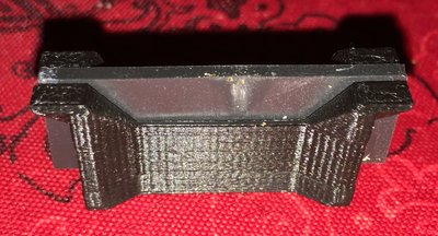

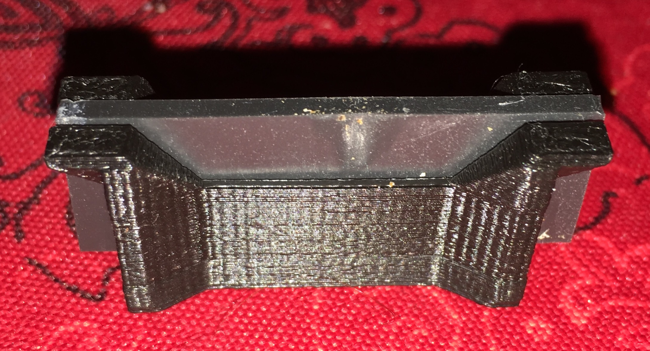

I had same issue. Guys at factory gave me some rubber supports to give some strenghtness to rubber.
