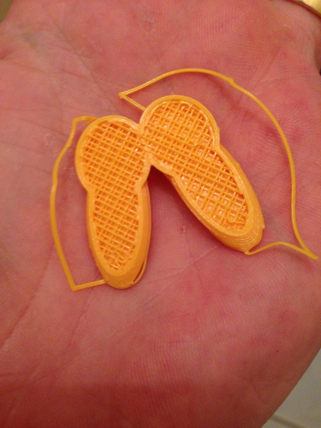

The first thing that is laid down is a ring which encompasses the actual print. Then the head starts to build the print within this ring.
However, in a few cases the head will build over the top of this ring. (see picture)
I am wondering how to turn off this outer ring to prevent it from causing issues.

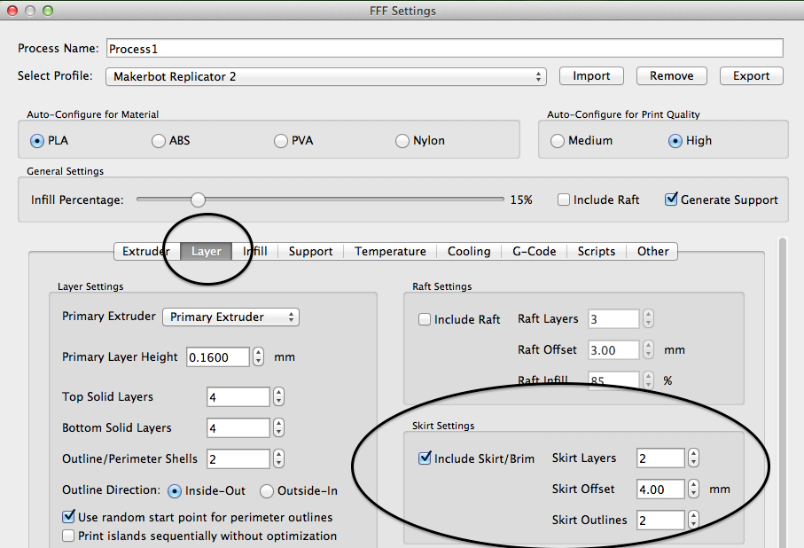

Locating the Skirt settings:
Open the FFF dialog box by double-clicking on your added process (bottom left panel of software).
Make sure to click on "Show Advanced" to get access to all the controls available.
Click on the Layers tab (refer to the attached image 1) and find "Skirt" settings at the bottom right.
The standard settings work just fine (2 layers, 4mm offset, etc.)

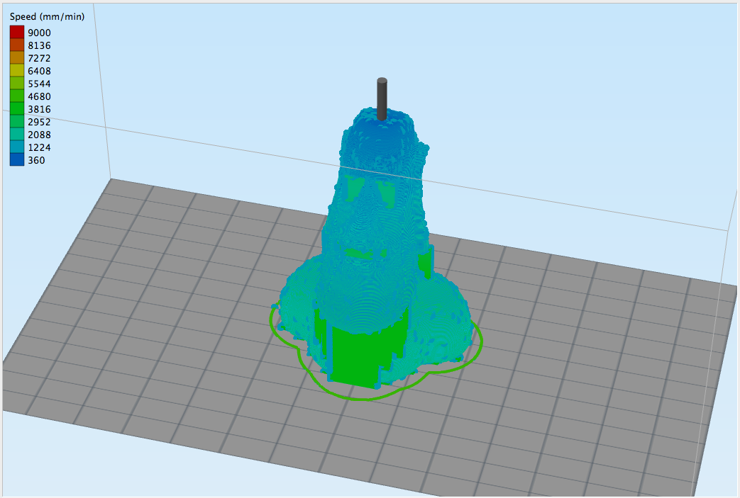

You will only see your skirt in the Preview mode. You can see my skirt in image 2.
Now, let's get to the root of your problem, which probably involves more than the skirt. I would bet your problem is about getting your first layer to stick well. It appears your skirt did NOT adhere fully, which caused a portion of the skirt to get intertwined in the actual part itself.
