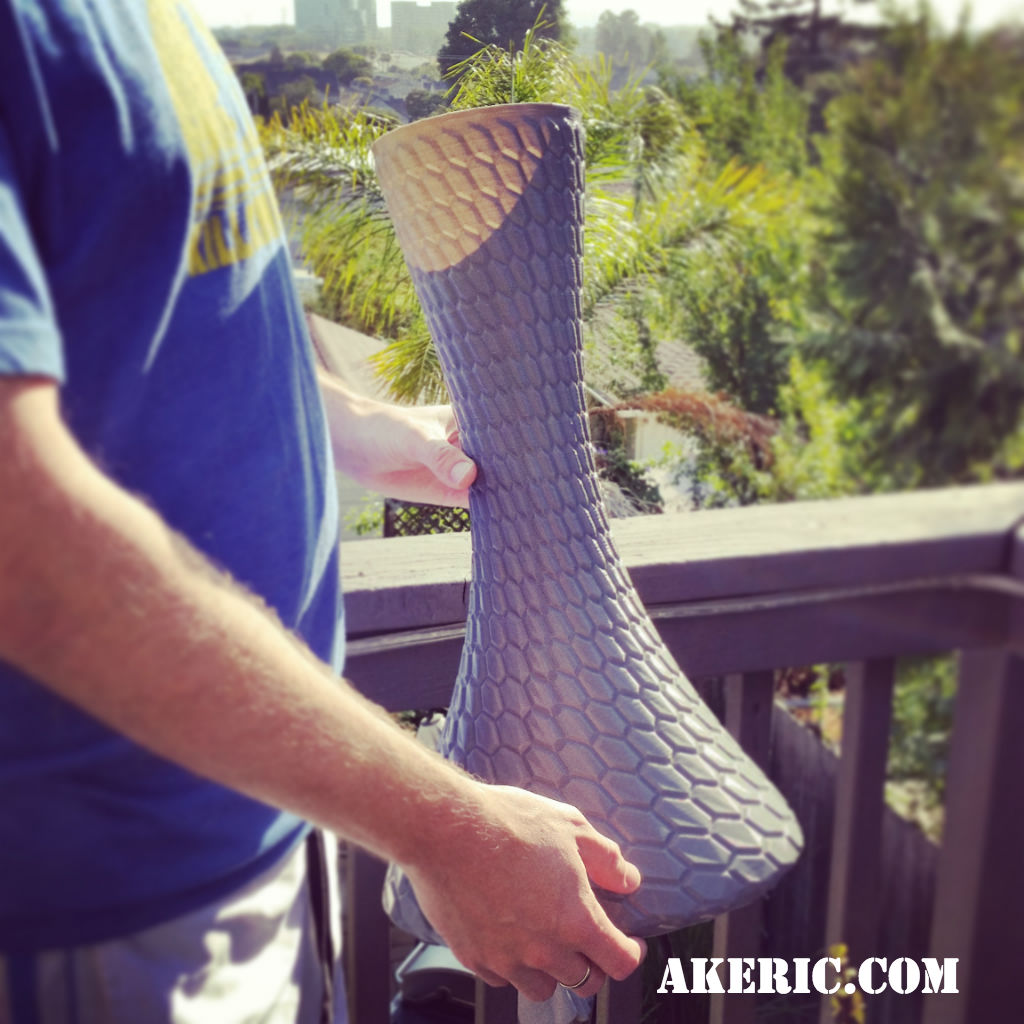

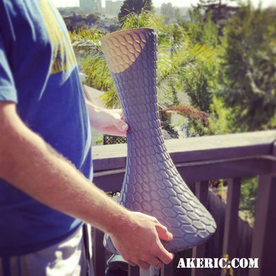

First 'really big print' from my custom core-xy bot:
http://www.akeric.com/blog/?p=3300 (more pics)
20" high, 11" diameter. 1.0mm E3d Volcano nozzle, gray PLA, 500 micron layer height, 45mm/sec, 'vase mode' (no roof, no floor, no infill, 1 shell) : 3hr 9min. Not too bad...

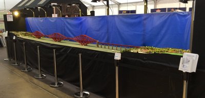

I know this is a long standing thread, but it's the most appropriate thread for this post.
Just thought I'd show what I've been printing on my Makerbot Replicator 2 over the past two years, half of which has been sliced by S3D. This is my T Gauge (1/450th scale) layout of the railway bridge over the Firth of Forth near Edinburgh, Scotland...which I hope many will recognise as one of the iconic railway bridges of the world:
The bridge structure is 17 feet long and is made up of over 1000 separate printed components (in PLA). The land areas at either end contain between then just over 350 printed buildings ....so overall there's over 1400 printed parts.
More detailed photos can be seen on my build thread on the Talking T Gauge forum which is over 30 pages long. Here's a direct link to the page containing the finished bridge: http://www.talkingtgauge.net/viewtopic. ... &start=300
