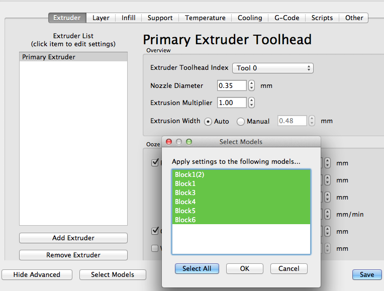

I print six pieces for a sliding-block puzzle. 2 of the pieces are identical. I import block1.stl, then I import block1.stl again, then block3.stl, block4.stl, block5.stl and block6.stl. Then I hit Arrange. I add my process and click (I think it's called) Apply to Models and make sure the one process applies to all six models. Then I print. I get six pieces (one entire set for a puzzle) on the bed in one "print job".

Good tip Dale. I didn't know how to apply one setting to multiple parts until I read your post. The "Select Models" button is on the bottom of the FFF window, right next to "Show Advanced". Now that I've set up all 6 models, I'm anxious to print the puzzle tomorrow and see how it works!
