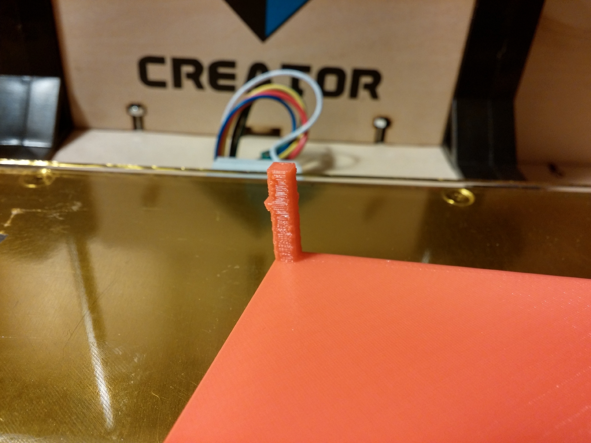

I've only owned S3D for 24 hours but so far I've noticed everything that I print has terrible corner quality. I'm coming from Makerware and I'm trying to get S3D to equal or better MW prints. Anyway, when I watch the extruder go around the small square column in the picture it goes around nice and slow and then it jerks outwardly really fast when it's done with the outside wall. Very odd. The rest of the part looks spectacular. Any tips? I can post some gcode if needed.
I also printed off a calibration cube that came out dimensionally awesome but again the corners looked like sh!t as compared to my MW cube.

I think I've answered my own question. I turned off the "use random start point for perimeter outlines". Night and day difference.
