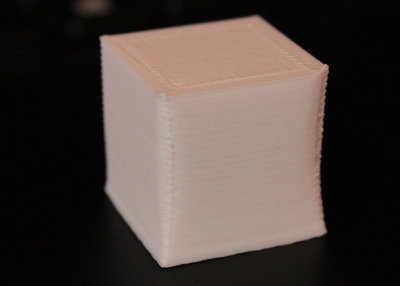

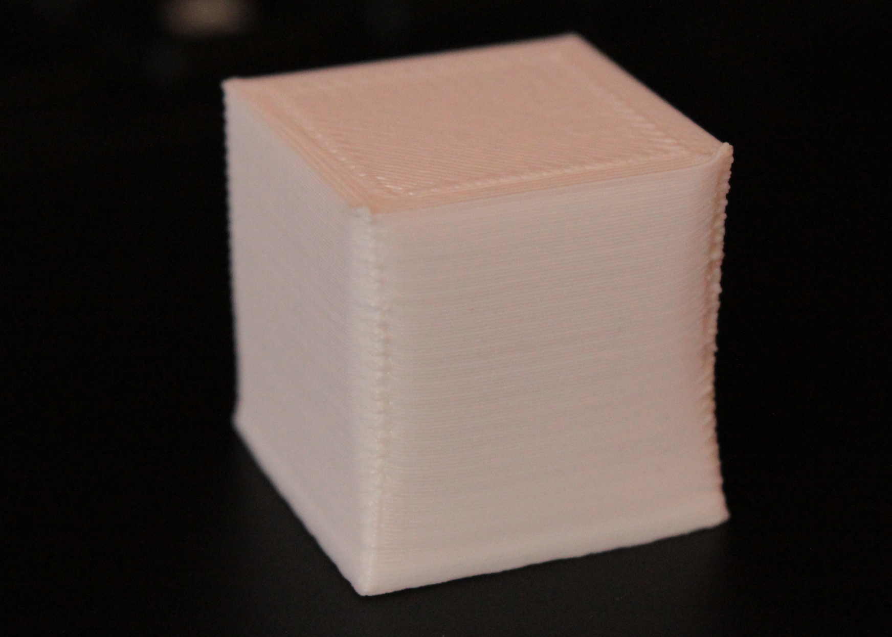

I have considered that the ABS may be cooling too quickly, causing the edges to curl before the next layer can be deposited. To that end, I printed several test cubes at different temperatures around 230º in 5º increments. I see no discernible difference in the output. The result is always a wide base with sides that narrow toward the middle and widen at the top. The corners curl up, giving edge lines a rounded appearance.
Test Cube
Test Cube
I also considered that the acceleration setting on the printer may be to blame. I turned off acceleration and printed another test cube. The speed was clearly more consistent, but the end product was no different.
Am I right in thinking that the problem here is due to the ABS cooling too quickly? Whether yes or no, does anyone have suggestions for how I might solve this?

I would actually say the opposite. I think you need MORE cooling. If it doesn't cool fast enough, it can curl and deform before it finally solidifies. So I think more cooling would help those perimeters stay put.

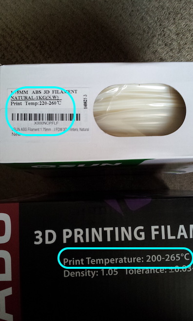

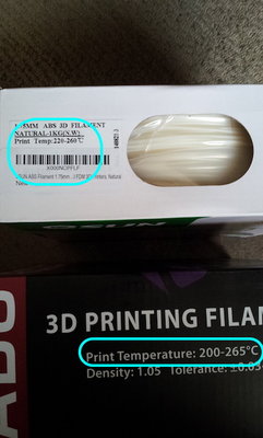

Look on the box of filament - the manufacturer will provide a Temperature range. As an example, attached shows two brands (Shaxon and eSun) - note their recommended temperature ranges. My machine prints only ABS and I’ve used a dozen different filament brands and each needed some parameter tweaking to get the results I wanted. Not all coffees are equal… I print ABS at 250 to 260.

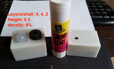

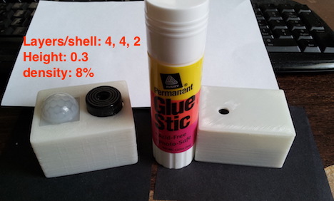

Differences in bonding material - I used them all and more consistently than others, the qlue stick in attached has become so reliable for ‘me’ and the DaVinci, that I tossed out everything else (sticks, ABS juice, tape, kapton film…)
Attached shows two items of similar size to your photo - they printed well (part on right has a lid glued on). Also attached is a model to try if you think it may be your part...
