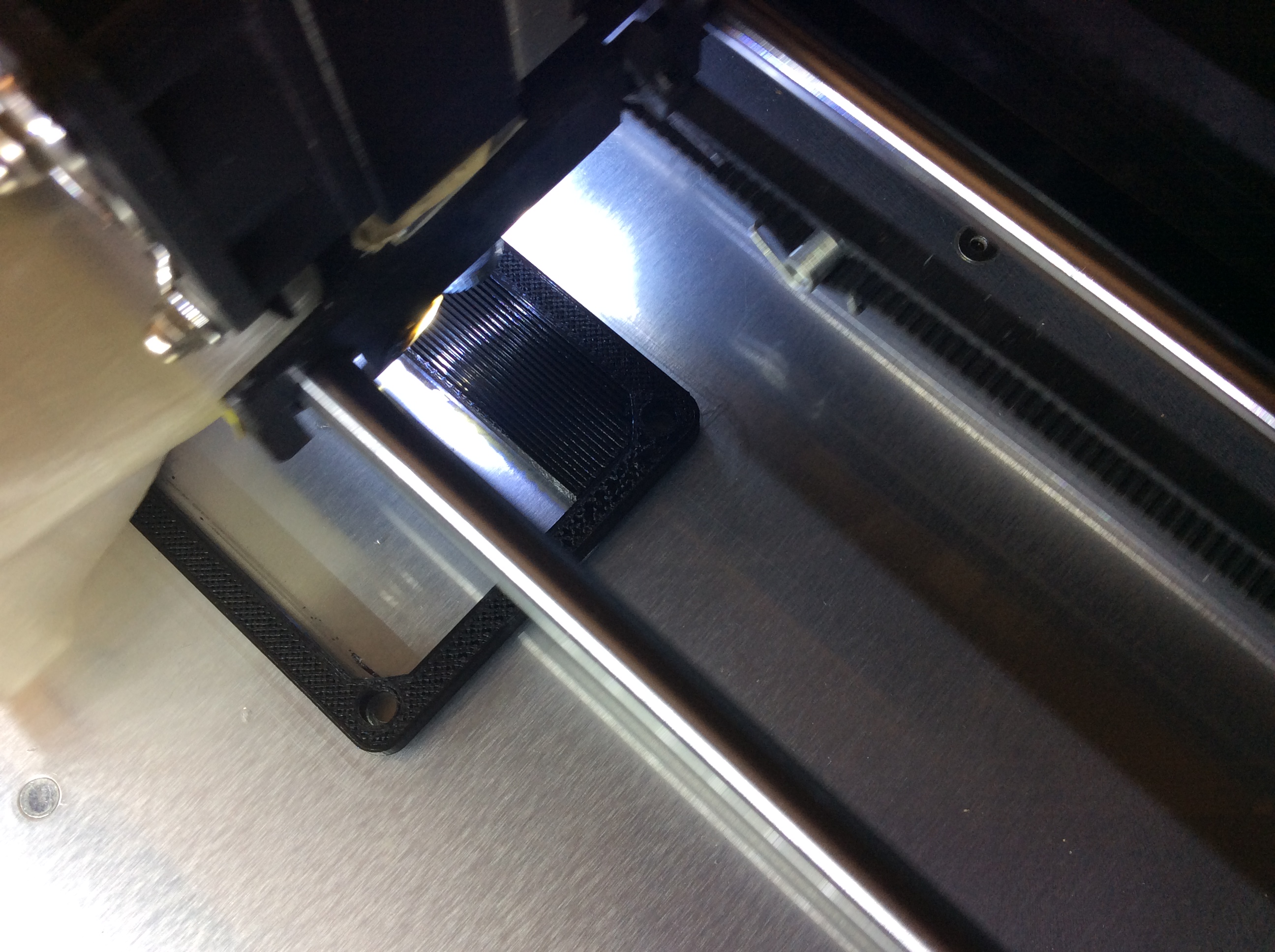

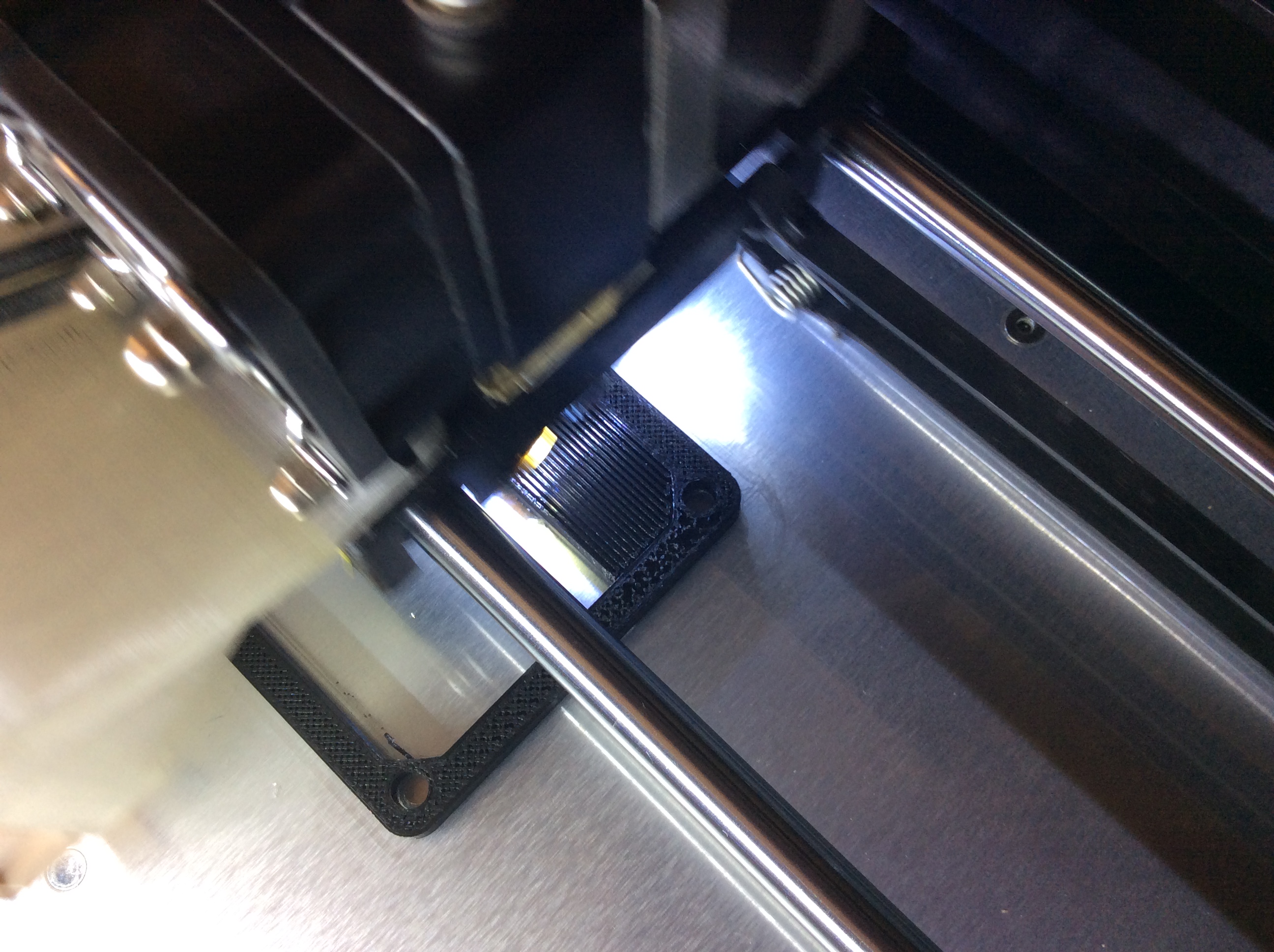

If one checks the pictures below then one can see the infill in the right top corner is acting strange allthough the full remaining part is perfect. The thing is that this reaches out until the top , so finally also the top layer gets printed weird in that corner.

try slowing down your infill speed, it may not have enough time to solidify properly. whats the fan speed as well.
Re: Can't identify print issue...
At a guess from the little info you have provided and the dark photos it may be either one or a combination of under extrusion and too few top layers.
Can you attach a factory file for this part ( File menu==> Save Factory file as...) and a clearer photo of the whole part please.
billyd
Posts: 279
Looks like retraction issues. Do you have any coasting set? Negative restart? Or it could be firmware related, again with pressure control of your extruder.
