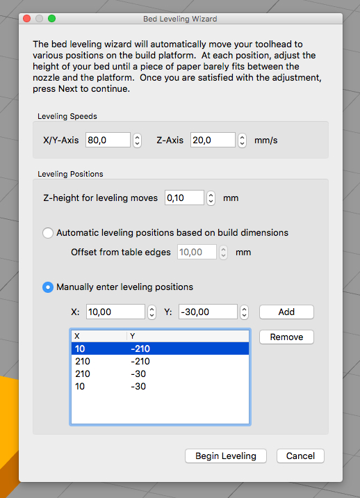

Now I wanted to use the 'Bed Leveling Wizard' inside S3D.
First I tried with option 'Automatic leveling positions based on build dimensions'. The built plane moves up and the print head moves from backside to front. But the head moves too far. The printhead crashed towards the case of my Ultimaker 2.
I switched my UM2 off immediately.
Then I wanted to try the other option called 'Manually enter leveling positions'. I started the 'Machine Control Panel' of S3D and used the 'Jog Controls' to move the print head to 4 save positions close to the 4 corners of the built plate.
I noted these positions and added them in the 'Bed Leveling Wizard' window as you can see in the attached screenshot.
Then I hit next inside the wizard. The builtplate moves up and the nozzle moves again from backside to the front. But again it moves too far. The printhead again crashed towards the case of my Ultimaker 2.
What I am doing wrong?

Ah, gotcha. The coordinates that you show in your screenshot look like they should be okay. Homing works well? Try manual controls from the jog window and see if you can jog to those coordinates.

Please read carefully! I already used the Jog Controls (see my 1st post) to get correct coordinates for the manual option of the S3Ds Bed Leveling Wizard. But even if I use these coordinates the head moves too far to the front (Y direction).
It seems that the Bed Leveling Wizard ignores the coordinates I entered or is doing something unexpected during finding the first position.
