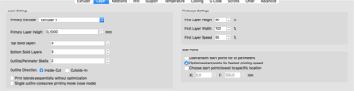

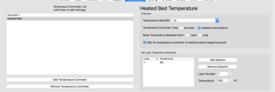

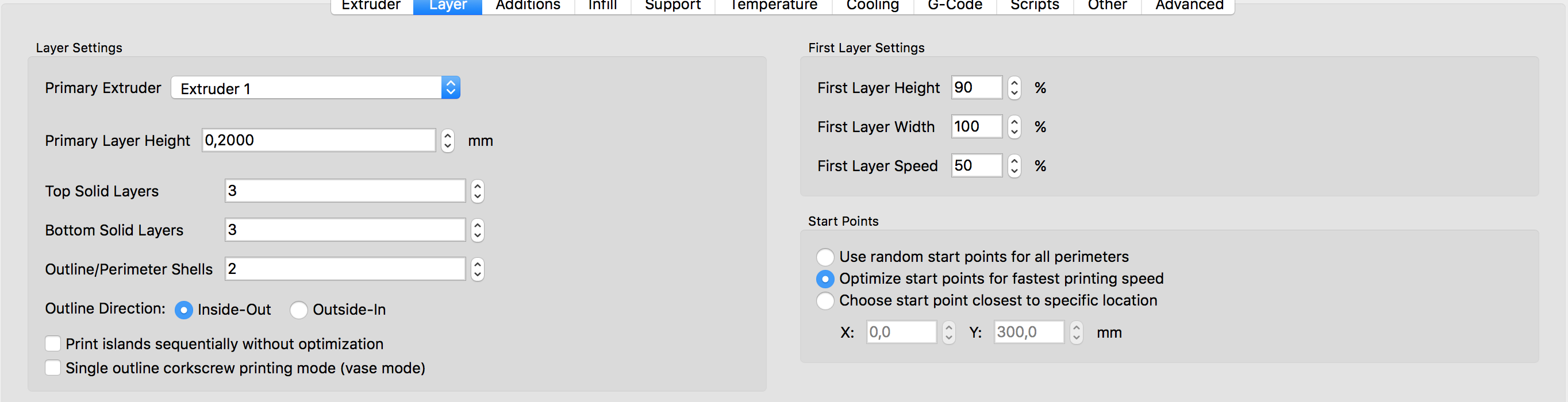

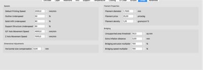

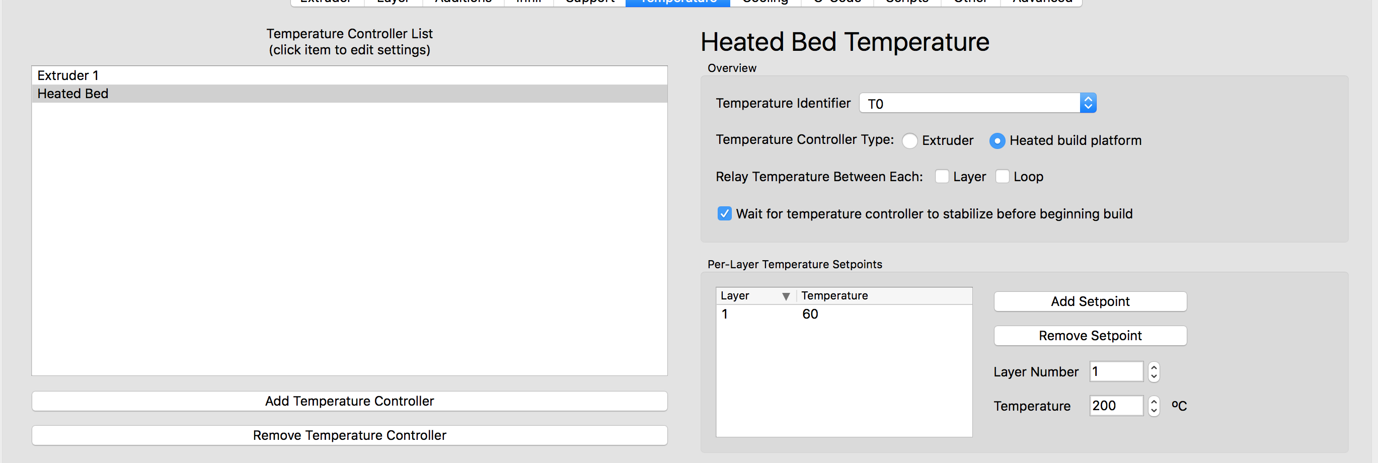

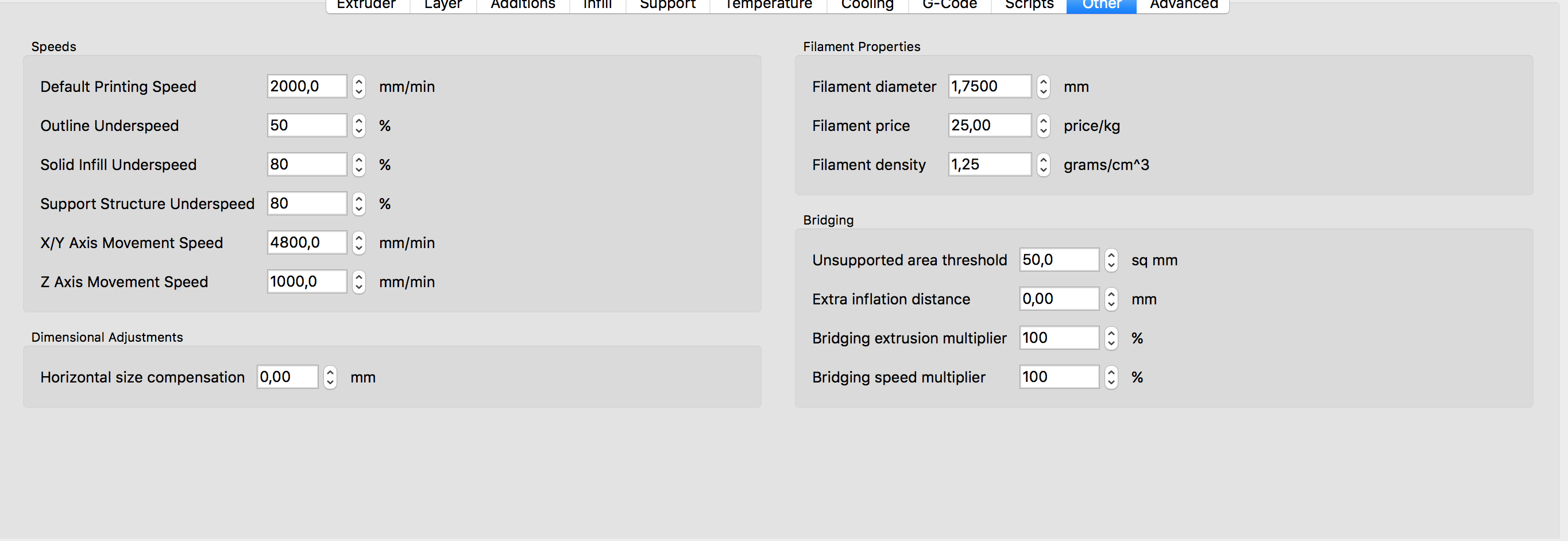

Here is my config for the extruder:
I level the bed with a distance between extruder an bed with 0.1mm
Extruder temperature : 190°C
Bed temperature: always 60°C
If you need a short result video , no problem.
Thank you!
Greets Alex
Re: unclean first layer
Your settings show a first layer height of 90%......which is exactly what you're saying is happening.
Change it to say 150%....or even higher, 200%....and try printing again.
If the results are a non-smooth surface on the bottom, you could amend the Global offset for the Z axis to say -0.1. This lowers the print down by that distance.
