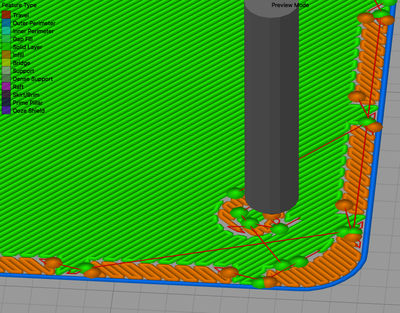

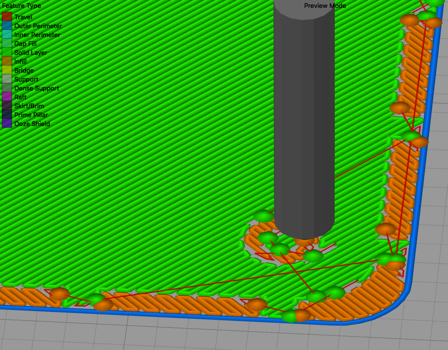

In some cases I want to have 100% rectilinear +45/-45 infill for some layers, and be using the same for the external (top/bottom) surfaces.
It would be nice if S3D could figure out these are the same, and not break up the rectilinear pattern to change from infill to bottom surface (as an example).
surface and infills are the same pattern

You can already do this right now. Instead of setting the Infill to 100%, go to the Infill tab and tell it to "Include solid diaphragm every 1 layer". That will merge the infill and top/bottom solid layers like you are looking for.
