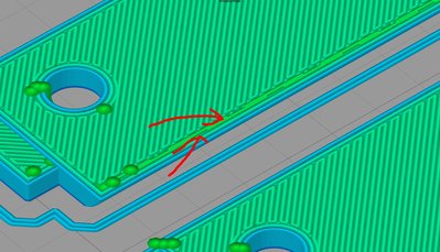

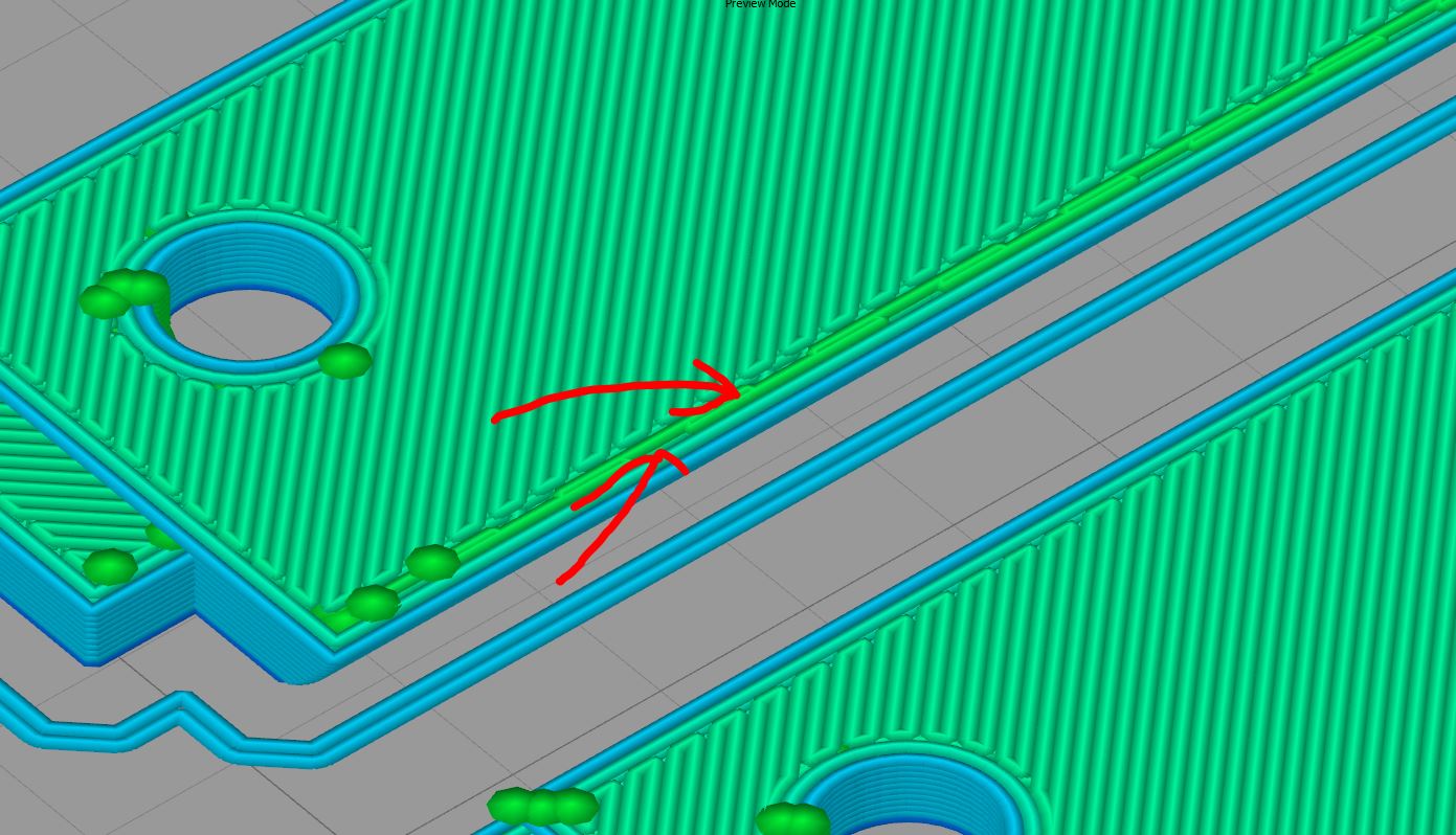

I´ve noticed a bug when I´m using triangular Infill.
If the filled area is very thin, S3D still tries to build the full triangular infill which means that the infill will be calculated 3 times in 3 directions (-60°, 0°, 60°).
In this case, this results in massive overextrusion because each spot of the infill get´s extruded 3 times.
I think that´s a bug of the infill calculation. S3D should check if an area get´s filled multiple times and delete the unnecessary toolpaths.
