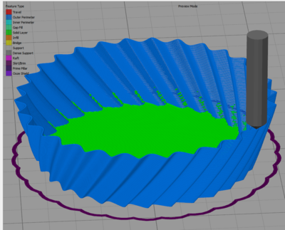

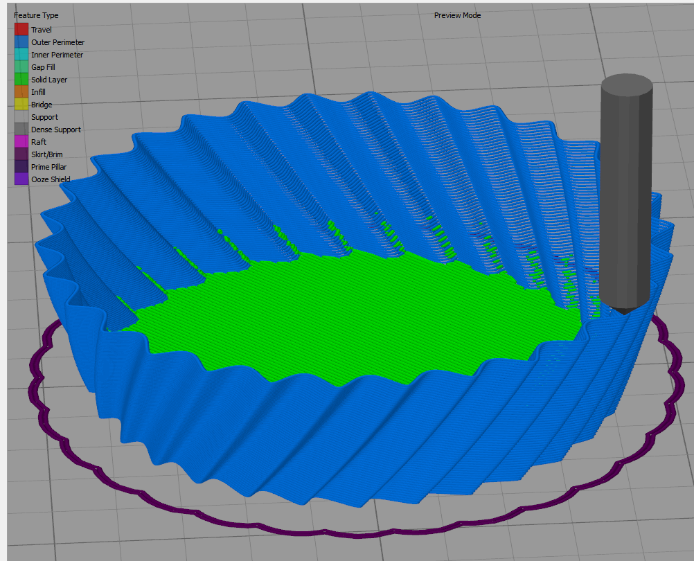

Here's the standard 20 mm box sliced with no infill and 1 perimeter:
@Mroek: I was very excited to see your post the other day that contained a screenshot of non-Vase S3D gcode with a single wall. However I've been unable to generate just such a beast myself. Could I ask that you attach a factory file so that I can see your full process settings?
Thanks,
- Bob

The reason your print has walls that are only 1 shell thick is that the walls are perfectly straight. Try to produce gcode for a single-walled version of the this STL without using Vase Mode. (External link because it's larger than 5mb.)
Vase Mode allows me to print any shape, no matter how thick the walls are, no matter the external twists and turns. I like all that. And I like that the it's done without per layer seams. I'd be even happier (read: satisfied. read: less frustrated. read: capable of making my design intent reality) if the various features of Vase Mode were unbundled and if Vase Mode jobs could be included in multi-process jobs, with the features, defaults and restrictions I've described.

It seems to work reasonably well, but if using bottom layers there are some extra printed lines near the bottom:

@mroek: The takeaway is that S3D DOESN'T honor your shell count setting rigorously except in Vase Mode. That's what everybody is complaining about..

dorsai3d
Posts: 237
Re: Unbundling Vase Mode
The reason it doesn't honor the perimeter count in this case is because your perimeter isn't wide enough to rest on the perimeter below due to the overhang, so the software is smart enough to add in a bit of extra plastic in an attempt to hold the whole thing together, rather than just squirting it out over open space. If you don't want it to do this, I think you can disable bottom solid layers and it might go away.
