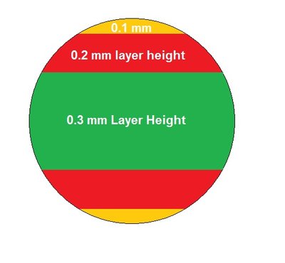

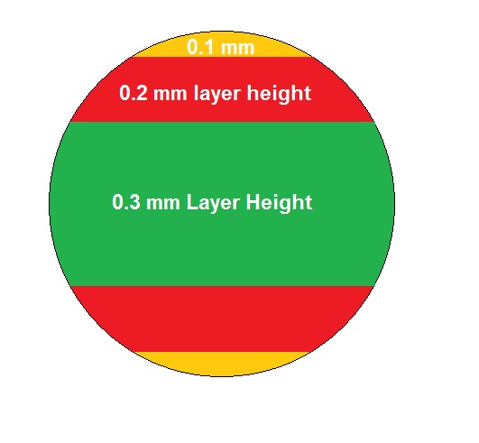

B) Surface Slope Angle
I noticed that the tops of models are the worst looking areas of my prints due to apparent stepping. There should be a setting that automatically selects smaller layer height based on the slope of the surface. This could be specified by user in angle range. As an example for a model slice at 0.3 mm, we can specify to use 0.2 mm for surfaces ranging from 40 deg to 70 deg and 0.1 mm for surfaces ranging from 70 deg to 89 deg. The sphere picture illustrates this.
