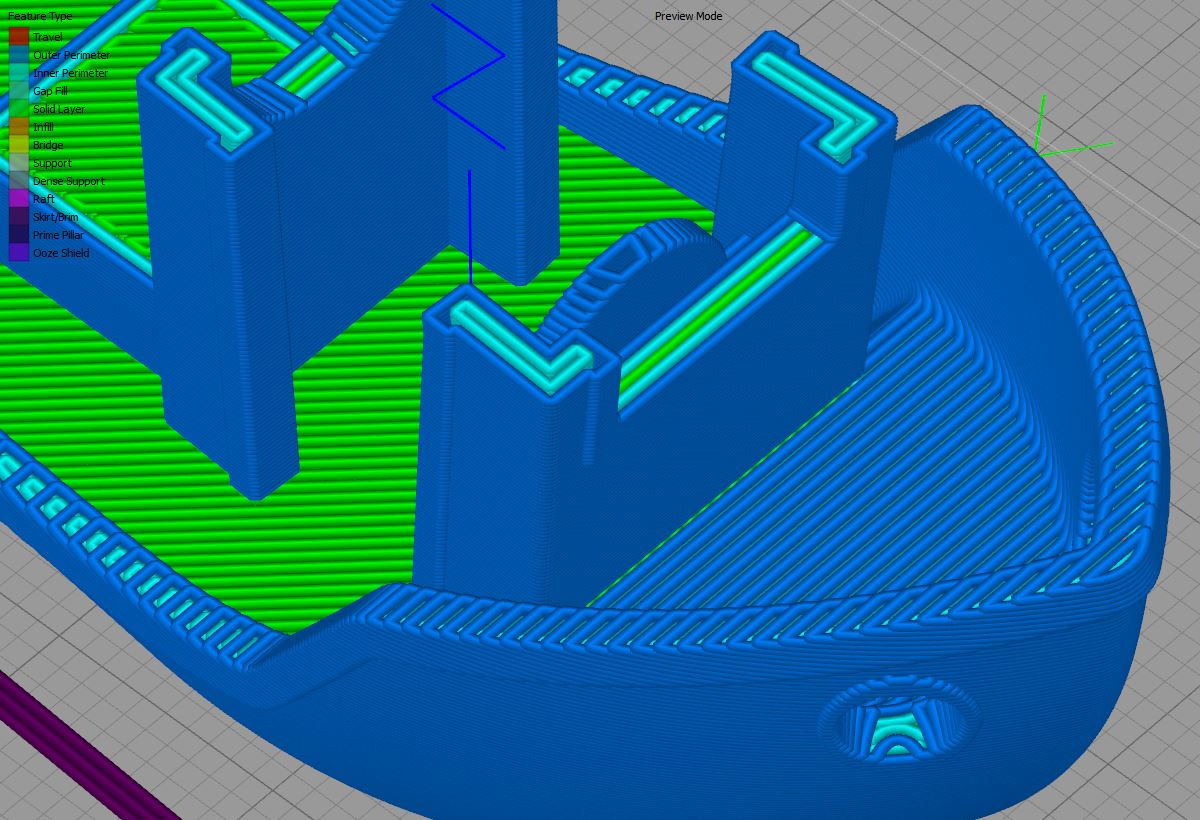

Hey guys,
Might be me just missing something but I think the model I'm trying to print got some missing layers:
(Could it be a problem in the STL? (got it from https://www.thingiverse.com/thing:763622))

I don't know what the multipart-complete file is there for. But have a look at this:
http://www.3dbenchy.com/3dbenchy-for-du ... -printing/
The one you're trying to print is all of those 17 objects together in one file. But that
means it has a lot of walls very close to each other while the simple STL file just has
"outer borders". Basically you're trying to print each part on it's own - but all at once
and very, very close together.
Have you tried the Slicing Behavoir options? Creating a single solid model should
slice properly.

Sometimes a picture is worth a thousand words :)
This is the multi-part STL you're trying to print. The slicer knows the window frame and the surrounding wall are different objects, each with it's own outer shell. But there is no gap/spacing defined between them. And even if the slicer could handle this without errors (which it can if the slicing behaviour is adjusted) - the walls would be way too close to each other to take the final print apart.
Here's the simple STL sliced, have a look at the window:
bye,
parallyze
