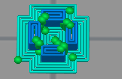

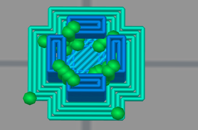

JohnB
Posts: 13
Joined: Tue Feb 04, 2014 9:33 pm
Re: Infill Pattern Issue
Here's what I get slicing multiple times without changing any settings...
