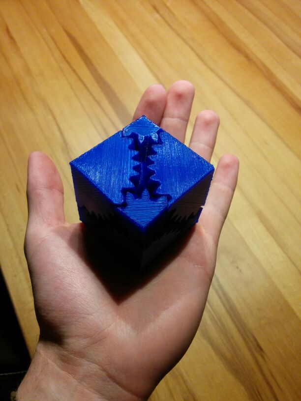

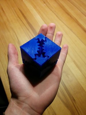

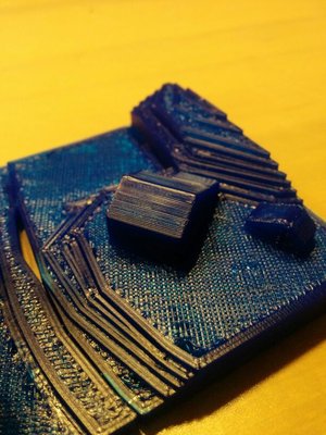

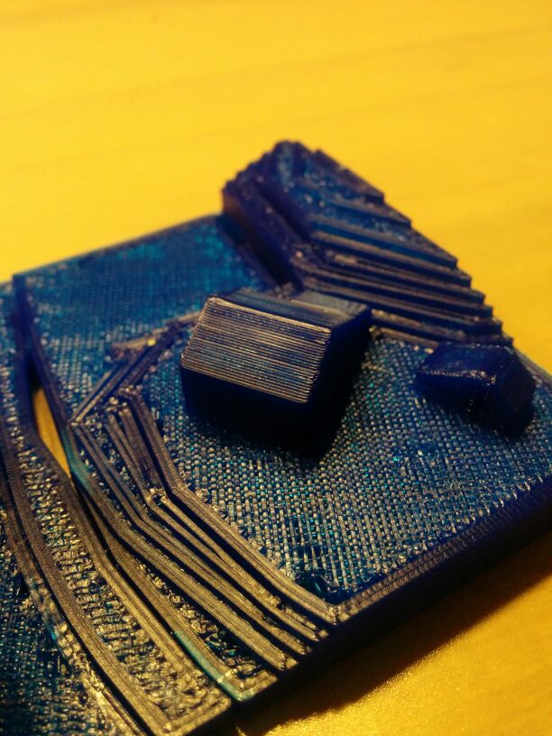

Hey everyone,
every time I print something with a layer height <= 0.15mm I got sparse infill instead of solid infill (see picture).
Also if I set the extrusion width manually below the automatic value (0.5mm instead of 0.8mm, nozzle diameter 0.4mm) there is way too little filament extruded.
The steps/mm, filament diameter, extrusion multiplier etc. are perfectly calibrated.
If I print with 0.2-0.25mm layer heights, the prints are beautiful.
Does anyone know a solution to this problem?
Thanks.
perfect infill (layer height &gt;= 0.2mm)
perfect infill (layer height >= 0.2mm)
sparse infill (layer height &lt;= 0.15mm)
sparse infill (layer height <= 0.15mm)
Re: Gaps in solid infill if layer heigth <= 0.15mm
You need to use a higher infill percentage when you go to low layer heights. Either that or a lot more top solid layers.
