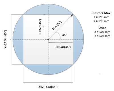

Interesting problem. The machine build dimension graphic appears to be off scale with cylindrical build volumes / delta.
In this image I have a 160mm disc setting on a 120mm build plate.
this image shows the size of the part.
Is this a bug or am I doing something wrong.
I keep crashing into my glass brackets if I don't pay close attention.
