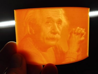

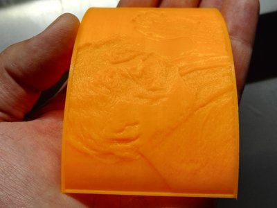

I get the best results making it 3mm thick (good detail decent contrast) I print vertically
this means at most 7 or 8 layers.
I just print with 0% infill but set permiters to 8 and use single extrusion infill
comes out very nicely. I have not tried doing this with simplify 3d generator (thank you for that answer IE using PNG :-) I will try it tonight.

I recently printed a lithophane using the online generator http://3dp.rocks/lithophane/ which has much more options. Then I printed with 100% infill in S3D @ 0.2mm Layer.
The result is stunning
