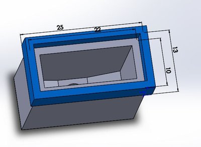

Why is it not full filled?

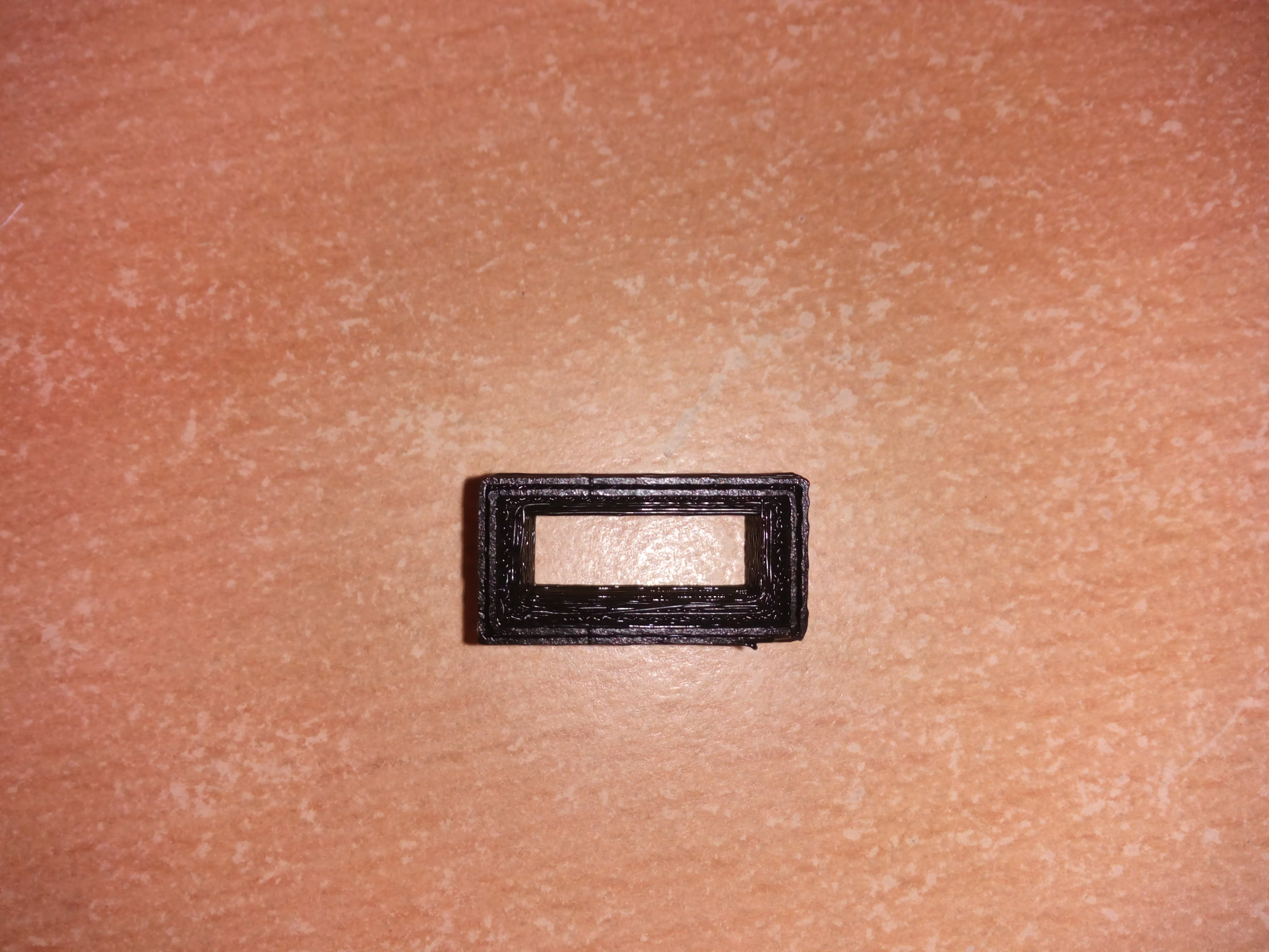

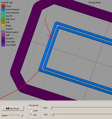

Hello,
as you can see in the Picture added, between the Skirt Lines are no space.
But between the first Layer Lines are a Space. ( mrked with the Red Arrow )
This Space between the Lines are also in the printed Model and i dont want that.
I checked the Parameters, but i dont know what Setting is responsible for that Space?
Can anyone help?
Thanks
Matthias

mroschk
Posts: 33
Joined: Mon Oct 17, 2016 10:21 am
Re: Why is it not full filled?
finished part...and fff file
S3D handles filling the gaps in a different way. especially when it has to do with outlines, you need a complete outline/perimeter to fill in the gap. Since it cannot fit another rectangle in that gap, it leaves it open. Set your First layer Extrusion width to something thicker like 120-150%. This will close the gap at least in the bottom surface.
Hello,
thanks for the reply.
But did you look in the FFF File i attached?
If i am right, and this is what you mean, i have 150% for the first Layer.
Matthias

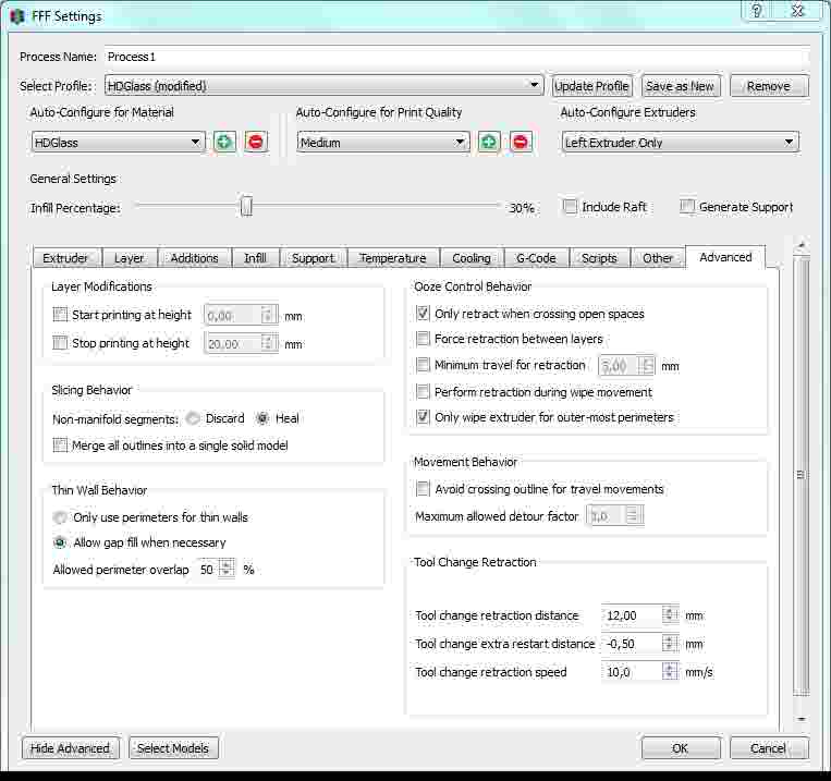

Try setting your first layer width to 120% and Thin Wall Behavior to Gap fill at 50%.
Hello,
i changed the "Extrusion Multiplier" back to 1.0.
Now it seams to work. Maybe that was the reason.
Matthias
kabali16
Posts: 159
Joined: Thu Jan 28, 2016 1:10 pm
Location: 4th Dimension
I would not recommend messing with the extrusion multiplier - this should be used only to compensate for over or underextrusion.
Try what Doug recommended. I set the First layer width to 100 and thin wall behavior to 50% and got 2 outlines complete.

Posts: 861
Tab Advanced:
