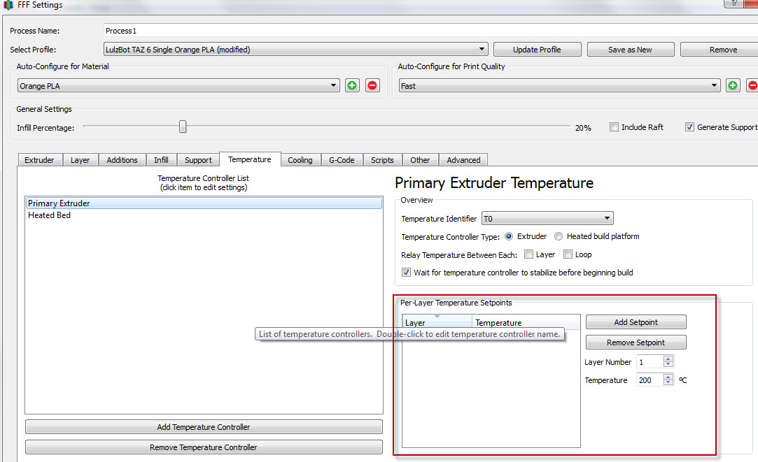

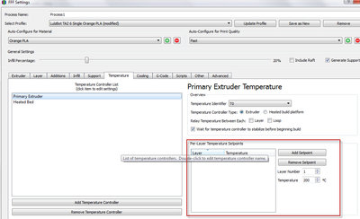

You can change the temperature by layer easy enough. The retraction settings however, would have to be by mm.
To adjust the temperature per layer, edit the process and go to the temperature tab. Select your extruder on the left. You should see the table to set your temperature points per layer on the bottom right of the screen.
Screenshot of the temperature screen

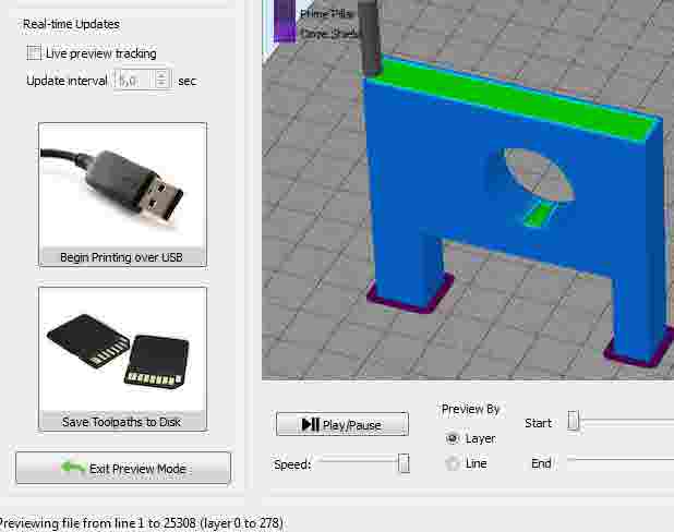

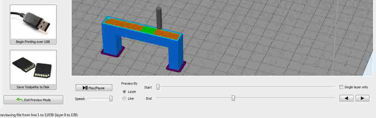

if you want to know the number of a certain layer it is very easy to realise!
Just start the PrintPreView, switch on the ViewByLayer and the number of the last layer is shown in the left window corner downside.
That is at first the last Top Layer, here no 278. Push the button with a klick and hold with the mouse and you can see the layers number at any point you wish to know, here e.g. no.139.
The line with the Layer- and Line-numbers is only shown on my laptop sreen, when I switch to full picture modus of the screen. Sometimes I must change between full picture and smaller screen modus and back, before this line is shown. But thats a problem of my laptop.

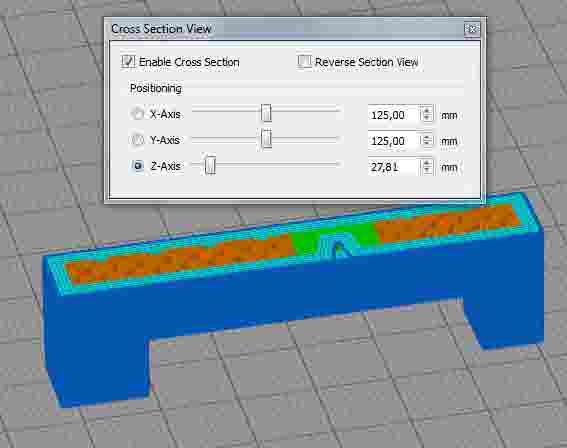

... that's right, but where is the problem?
I.
If the number of layer is known, he can read out the millimeters out of the gcode. Surely not very comfortable but very exactly.
II.

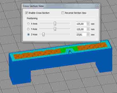

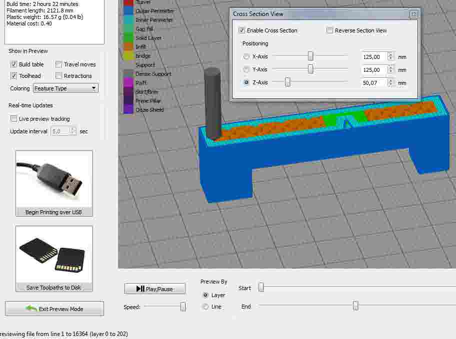

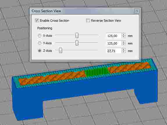

First going down to the layer as wished, then open CrossSectionView and also helpfull is showing the toolhead.
Going down with the CrossSection "Z" until the toolhead is disappeared.
That is the last layer obove the point we look for. Also easy to identify with the changing of the object-view when going lower with "Z"
The example shows this point between 27,81 mm and 27,71mm , also +/ - 0,1 mm true value. Thats enough I think.
