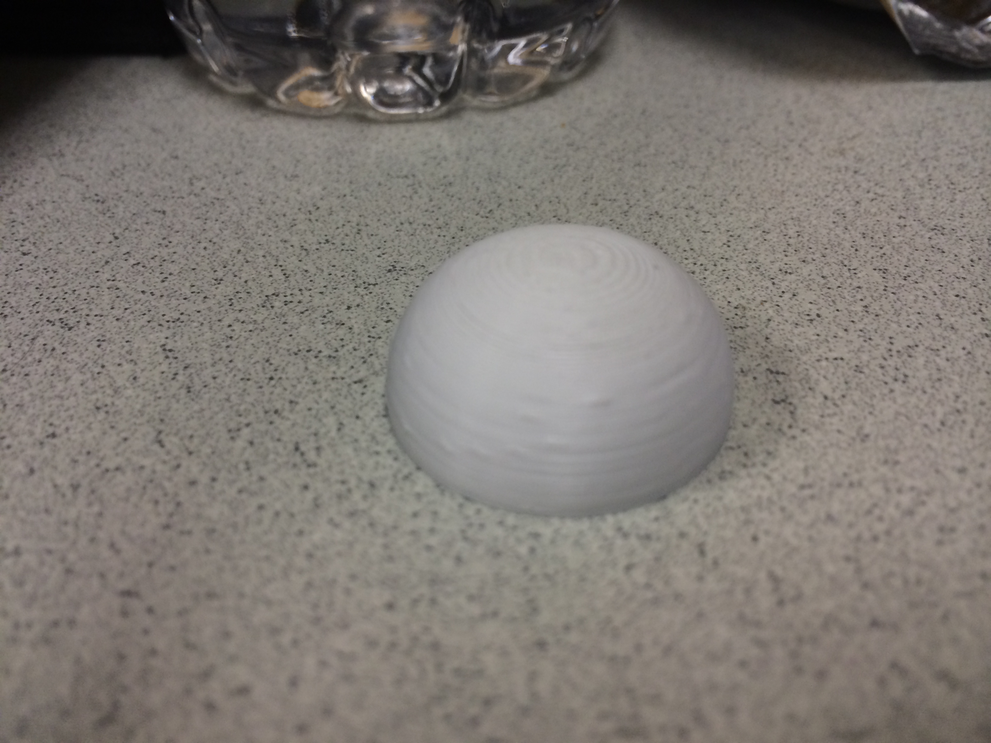

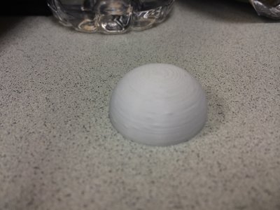

paradigmcmi
Posts: 9
Joined: Thu Feb 20, 2014 12:26 am
Re: Zits.
I'm still seeing "zits" while printing using continuous corkscrew mode, which is odd considering that it's not retracting during the process. Anyone else notice this as well?
