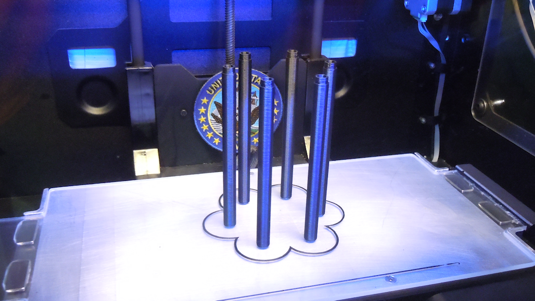

Ok
The MakerBot Replicator 2X, Dual extruder....
Shut it down last night, went to sleep.
Got up this morning, fired up the Printer, preheated the Bed for printing of the parts.
S3D begin print over USB, warmed up extruder, and off she went.
Printed parts just fine, hmmmmm, interesting it was, after 1 hr print job., I decided to try something.
Let the printer cool down, used the infrared heat gun and saw extruders where warm 150 deg F.
After 2 hr cool down. fired up printer to print out 6 more round small parts, in a radial array pattern.
This way they are spread out, so far at 97% and going great, 2 hrs into printing parts and doing good.
So I think letting the motors cool down for a good hour or more is the trick, I think....
Did not change any parameters in the settings, loaded up objects, after I did a radial array in the modeling program.
