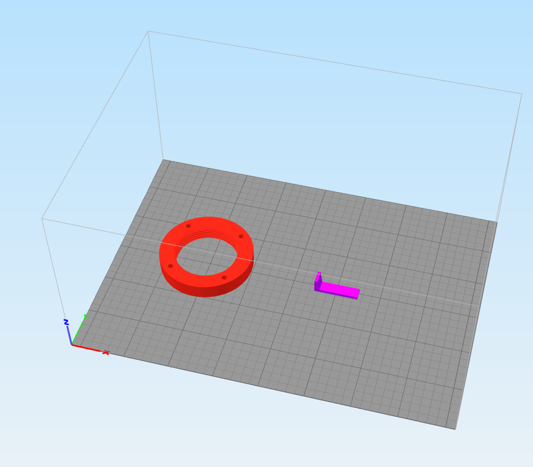

LMAO, I had exactly the same issue, and wondered why too, but you can get around it... by using this, and not having to re-import your models, if you forget to uncheck that tick box. It doesn't make that default acceptable, but it saved me from cursing them "developers".
