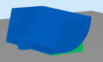

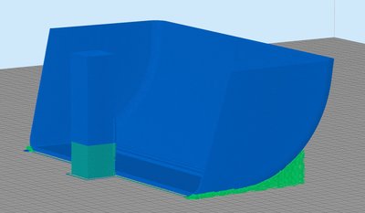

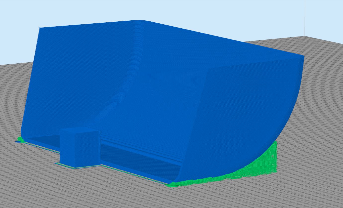

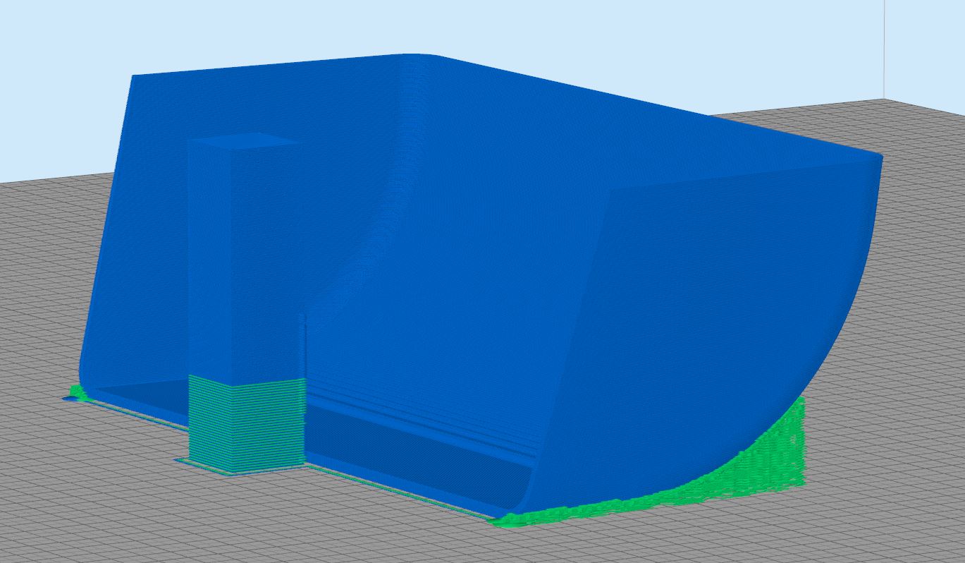

The problem, on the first process the prime pillar don't integrate the support head!??
Why?
With one process for all i see the dual head on prime pillar, you can see it on the factory file!
Ps. the part on factory file is just an example for illustrated
multi-process.factory
(863.19 KiB) Downloaded 524 times
