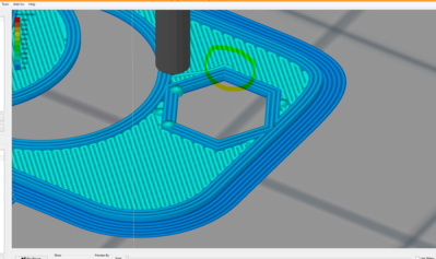

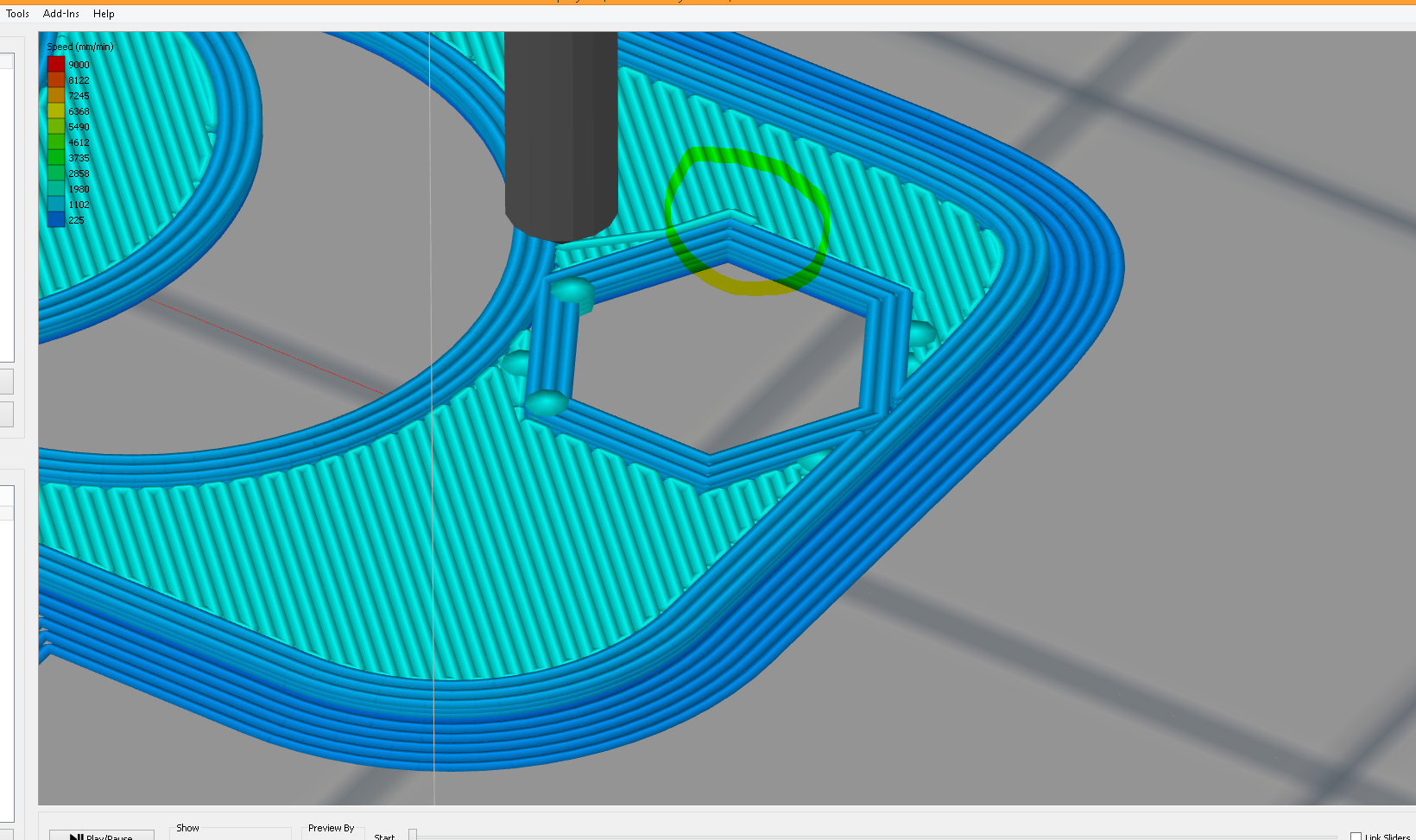

So, i have my second extruder set up to run the infill of an object. Both extruders are in a single Process, both are configured for a retract to prevent oozing into other layers.
For some reason when the tool change occurs after perimeters are laid down, the second extruder will not prime the nozzle for the amount which was previously sucked out. it will however throughout the infill process continue to prime/suck accordingly.
here is the start of the path, see it is missing the prime:

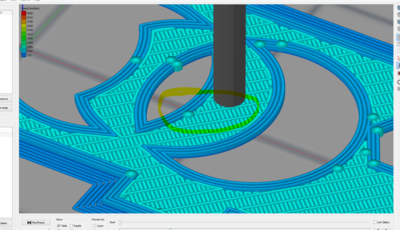

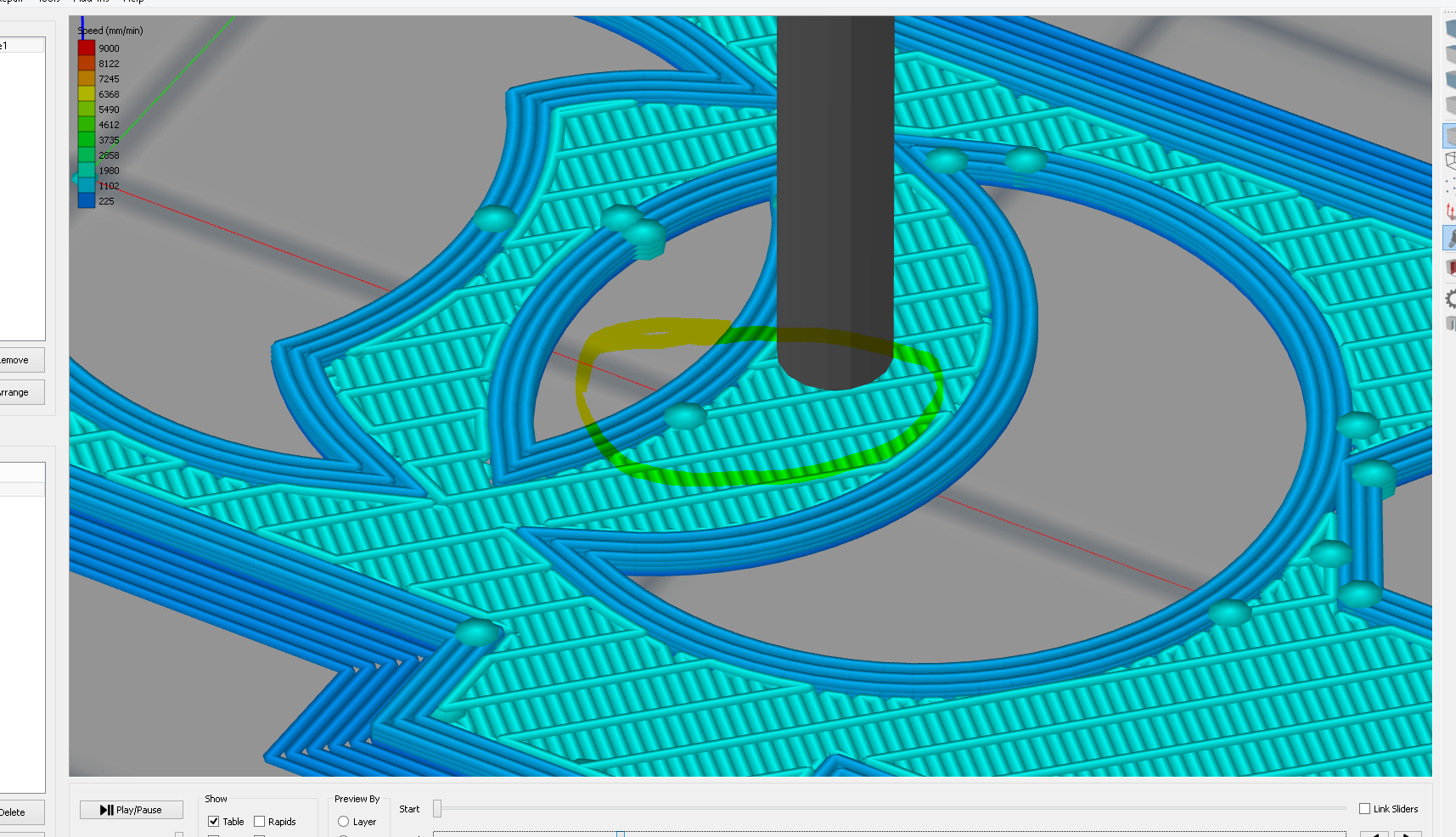

here is the end of the path where it sucks to prevent oozing
i do not see this when the second extruder is configured to run a second material.. only when it is selected to do infill. I have no custom gcode for tool change, i am using a rostockMax profile.
