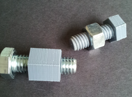

[added 3/8-16 bolt]
[added FactoryFile]
FYI - a word about the attached STL
Printed results will vary depending on:
Material & shrinkage
Print parameters (particularly the Flow Multiplier)
Machine/accuracy
Zits/Blobs/Strings…
I print threaded parts with 4 shells because chasing with Tap/Die will cut into the wall - thus, ensure you have enough material to remove.
If making threads and don’t have Tap/Die, you can scale one part in the plane of it’s diameter. But, for $10 you can buy useable (low quality)Tap/Die sets at Harbor Freight
Bolt_3_8_16.factory
FactoryFile
(1000.79 KiB) Downloaded 272 times
Bolt_3_8_16.STL
3/8-16 Bolt
(1.99 MiB) Downloaded 252 times
Printed & Chased
Printed & Chased
