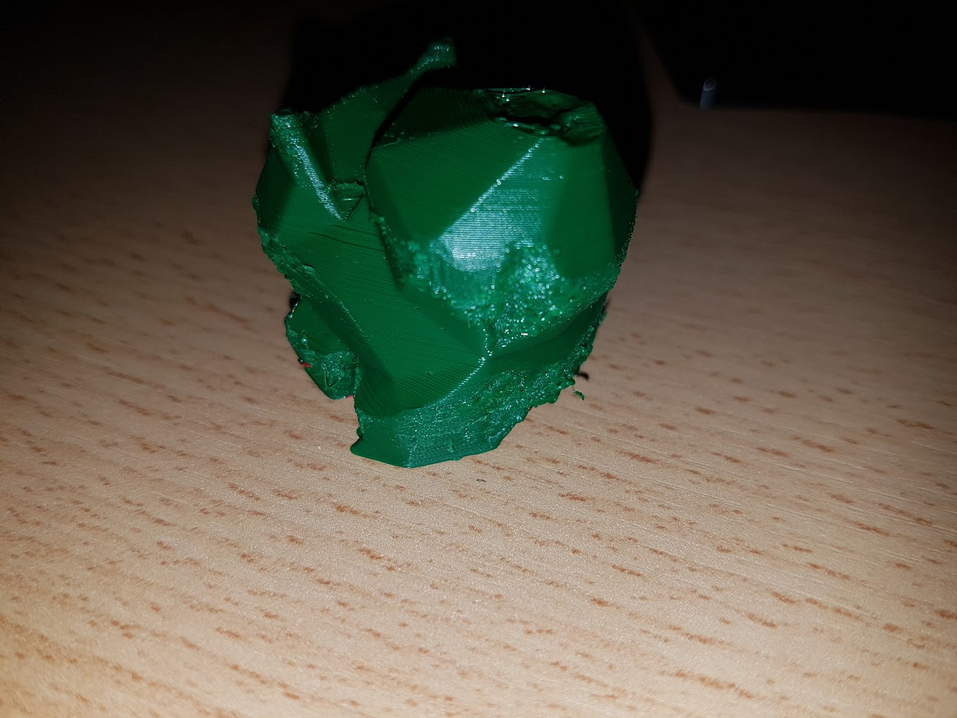

I've tried the new model, but unfortunately I have the same result...
I don't know why, but the problem seems to happen always at the same layers, even if I split the model in different parts...

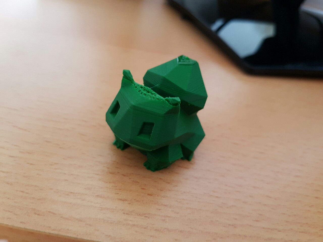

Sooooooo, I've made the modifications you suggested (correctly, I think) :
bulbasaur_starter_1gen_flowalistik_v2.factory
(10.6 KiB) Downloaded 163 times
The result is "awful", BUT ! The ears seems to print way better than before !
I don't know why the rest looks so bad...
Anyway, progress have been made, thanks to you :)

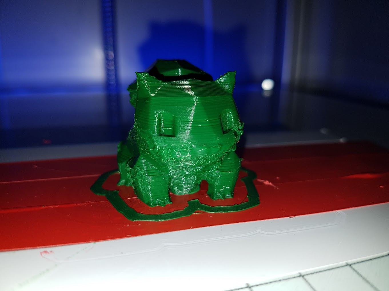

Well, after all the tests I've made, I think that my nozzle is clogged. I'll try to clean it tomorrow... Anyway, thanks for your help, I'll try to print your version as soon as my printer is clean.

Finally ! I've succeded with my print, and your help :)
I've restarted with the default parameters from Leapfrog, then augmented the Fan Speed, slow down the print speed, and the extrusion settings, and I've got an acceptable result.
Now that I've found a good print setting, I will try to print a new fan duct.
