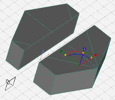

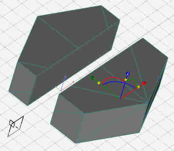

What CAD-program do you use?
I have ViaCAD and I'm able to split an importet STL in any way and re-export the new parts as multi STL's to print them optimal.
H.

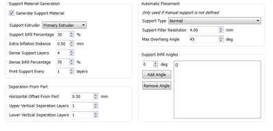

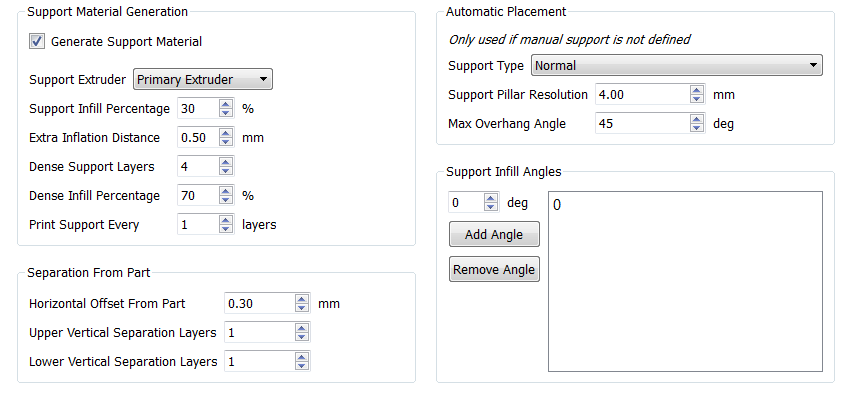

It is a 3D scanned model from Scan The World on MyMiniFactory https://www.myminifactory.com/object/tw ... mbat-23491
Not sure how to use separation layers. We are going to try this support setting in our next print.
We added a little to "Extra Inflation Distance" (0.5mm)
And 4 "Dense Support Layers"

The automatical support of S3D is not optimal, I suggest to try the manuell support and play with the values of the columns.
Dense will build a column with a head like a mushroom. More dense layers so the head will be width.
You need ultimativ the vertical SeparationLayers 3 or 4, you must try out.
The horizontal distance must be >0,5, so that the columns do not touch the model.
