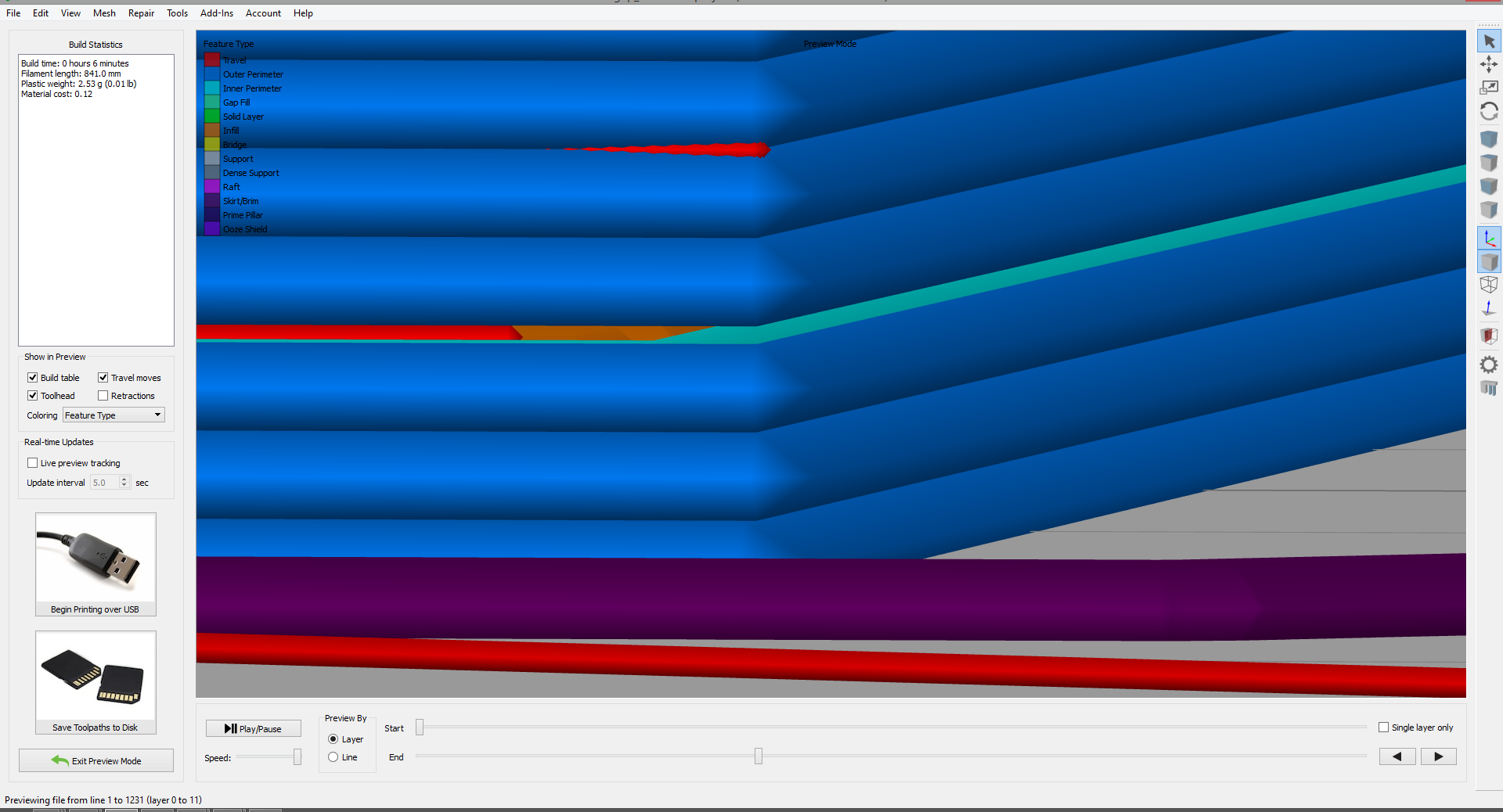

I had previously noticed an unexpected gap between layers when using multiple processes with specified Z-range ("Advanced" tab, "Layer Modifications". Thought it was because I switched primary layer height between processes (and that might still be true), but I noticed another case where this gap between processes is showing up. Basically the z offset caused by using a first layer thickness different from 100% is only accounted for within the process (2nd and subsequent layers are offset appropriately). However, the next (and subsequent) process that is applied when Z falls into the next z range specified does not account for the actual position of the layer below. This shows up in a gap in both the preview and in my case in the actual print.
I figured out that I can compensate for it in the Global offsets ("G-Code" tab), but I would think when specifying processes that cover a continuous Z range (i.e., Z-Start of last process = Z-Stop of previous) the layers should be sliced with no gaps appearing. This probably happens when changing layer thickness also since the slicer doesn't seem to utilize the position of the last layer in the previous process. Anyone else notice this happening?

I actually created a more simplistic example. It has two processes 1) Bottom - stopping at Z=0.9mm and 2) Top - starting at 0.9mm. The primary layer height = 0.3mm for both processes. The "Bottom" process has a 1st layer with 80% height = 0.3mm * 0.8 = 0.24mm. The top layer has a 1st layer height setting of 100%. What you can see in the attached factory file and screen shot is a gap between the 3rd layer (last layer of Bottom process) and the 4th layer (first layer to Top processes). From the attached G-code the starting 3rd layer code is:

(1.5mm - 1.2mm = 0.3mm) The Z position of the 3rd layer is correct for the Bottom Process (80% * 0.3mm + 0.3mm + 0.3mm = 0.84mm). The problem is that the 4th layer starts at 1.2mm as though the first process sliced at even 0.3mm layer heights. Layer 4 should really start at (80% * 0.3mm + 0.3mm + 0.3mm +0.3mm = 1.14mm. But as you can see this will leave a gap.
I think this issue also pops up if you have two processes with different "Primary Layer Heights" even if first layer thickness is set for 100%. I think each process is essentially assuming that all other processes sliced at the same layer height (and therefore Z-increment) as the process doing the slicing for a particular Z range.
I've attached files that demonstrate what I'm seeing for the case with same Primary Layer Heights, but a 80% first layer for the bottom process.
