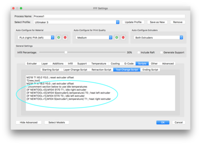

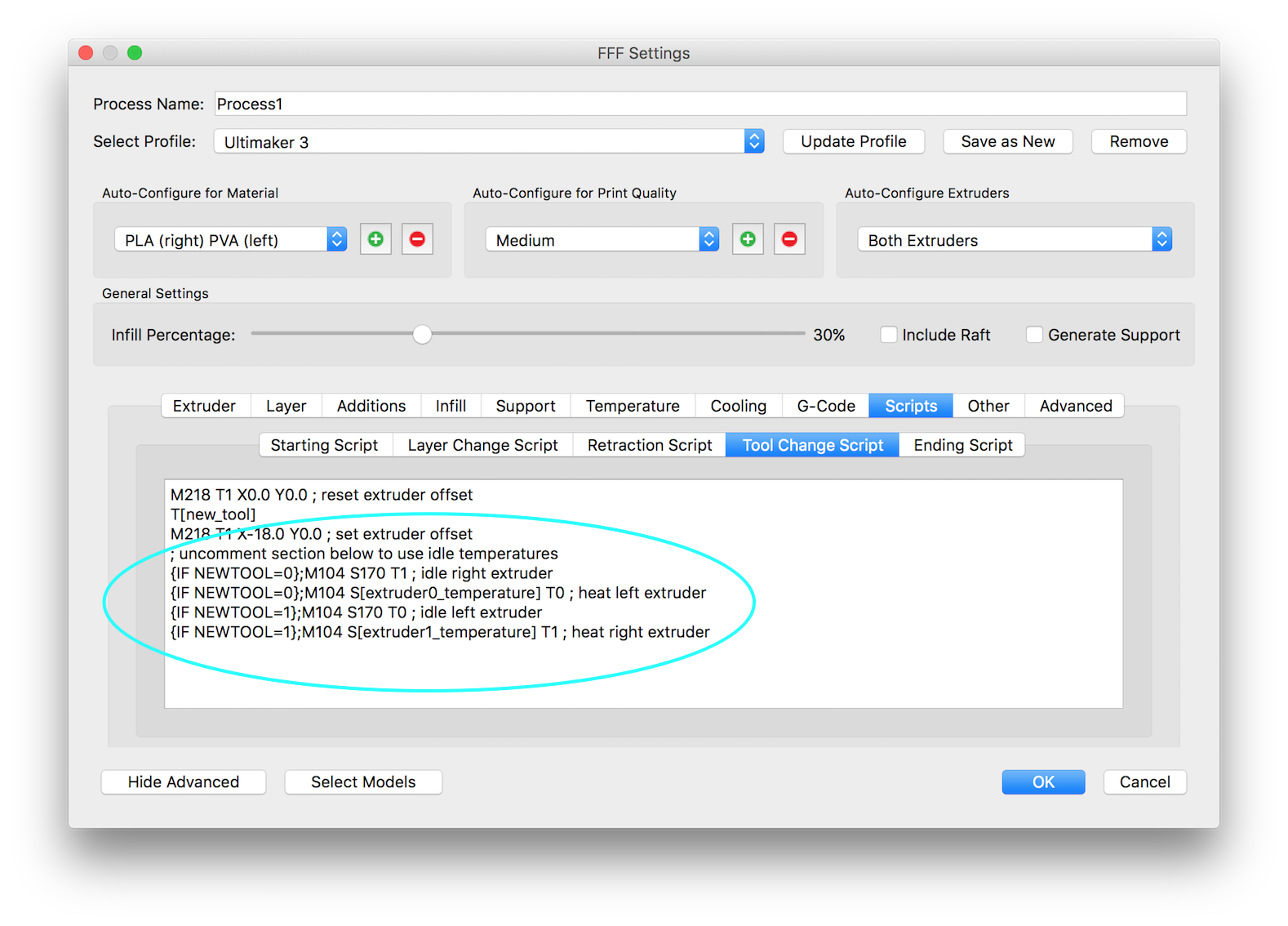

Hello DarthRevan,
I would really be thankfull, if you could me explain this bellow more detailed, what I have to do to get the temperature from the idle extruder down.
I tried it with your description, but it did not work. If possible send me some screenshots what I have to change. I use the Ultimaker 3 and have not really experience with 3 Printer. In the cura porgramm it is easy to do it, but with cura I cannot use the full size from the printer.
2. This isn't something that I personally use, but if you want to have the idle extruder cooldown between every layer when it isn't being used (I think cura does this by default), you can enable that in the Simplify3D tool change script. Just remove the semicolon before the last four M104 lines in the tool change script. If you want the print to completely pause until your set temperature is reached, change the 2nd and 4th M104's to M109's so that the machine waits to heat back up from the idle temperature. The default temperature set for idling is 170ºC, so if that's not what you want to use, you can just edit the M104's to use whatever temperature you want.
Thanks in advance
Best regards
David

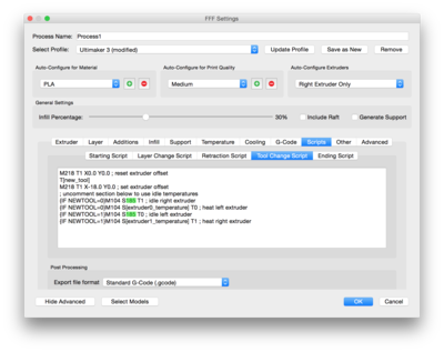

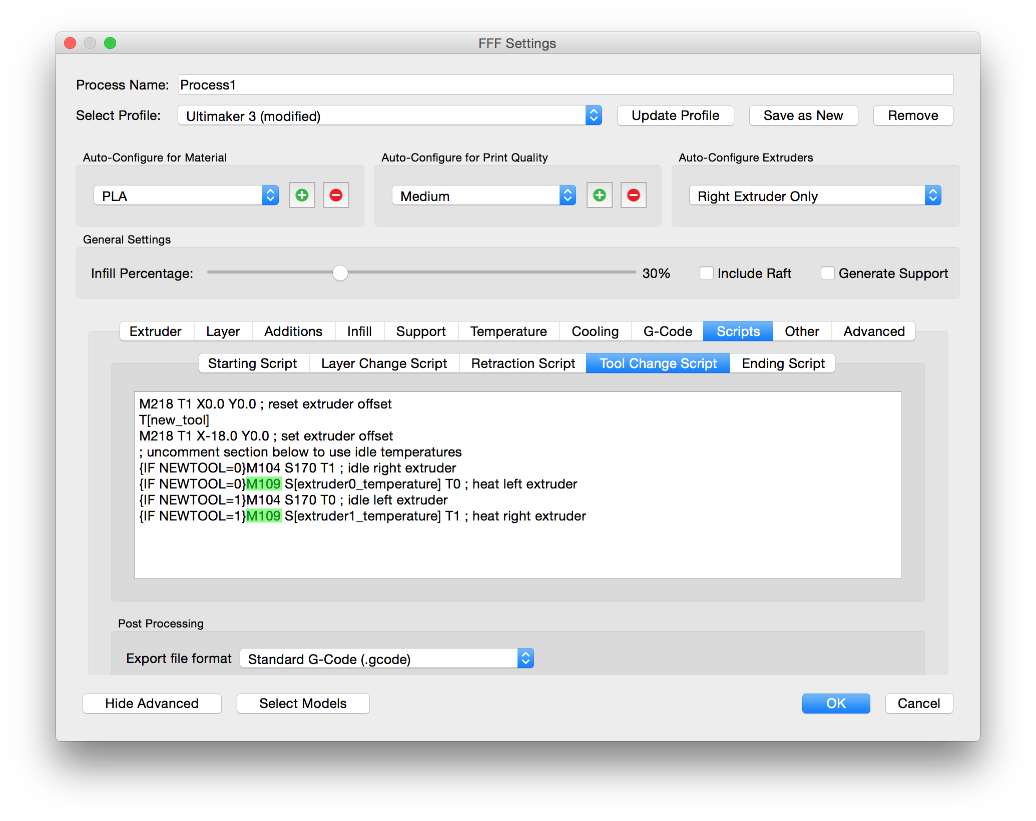

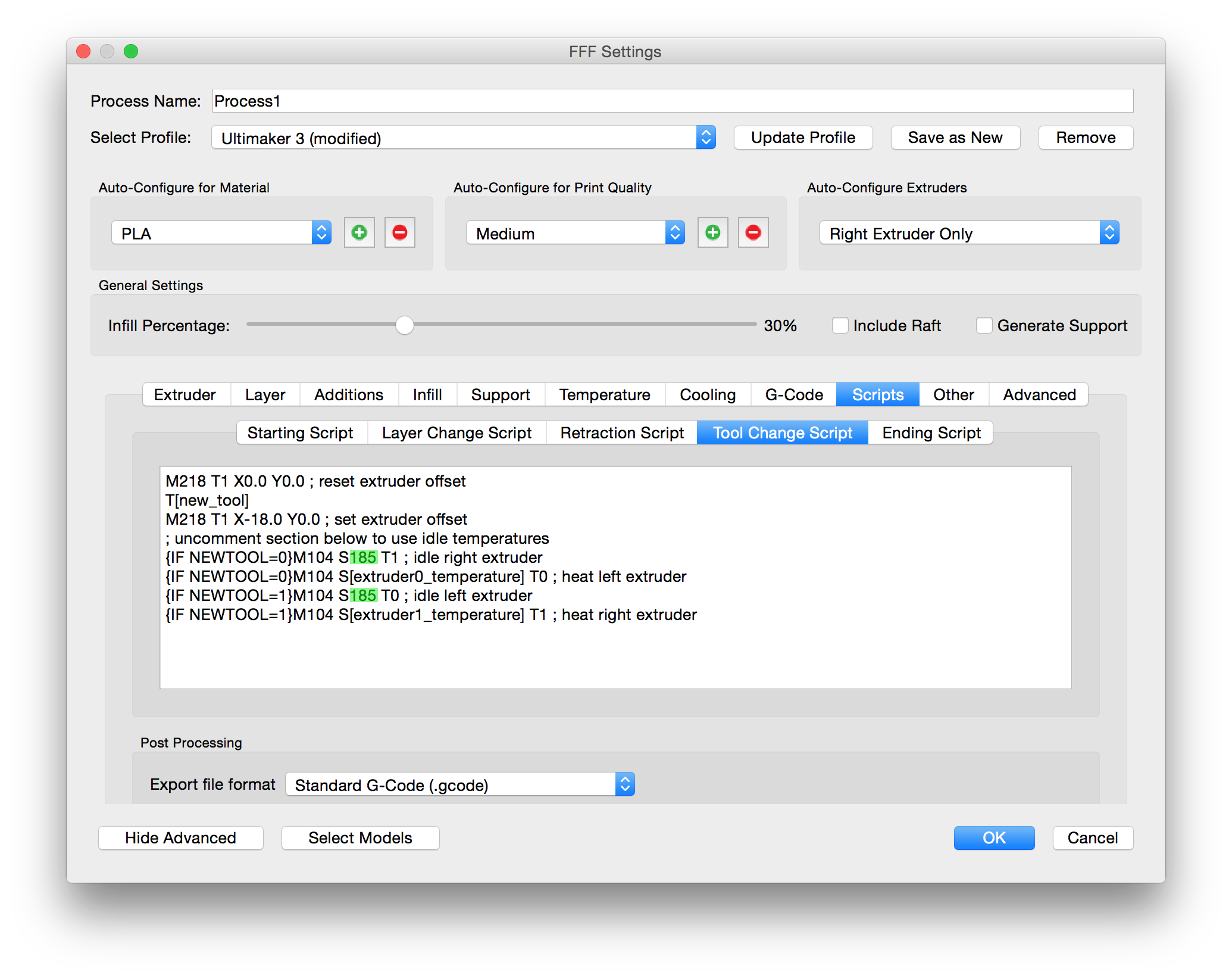

DarthRevan
Re: Ultimaker 3 Profile PLA & PVA additional Tips
This is what it should look like if you're not going to use M109 commands to wait for the temperature to heat back up.
This is what it should look like if you change the heating back up lines to M109(s).
This is where you would change the idling temperature. In this screenshot I changed the default of 170 to 185.

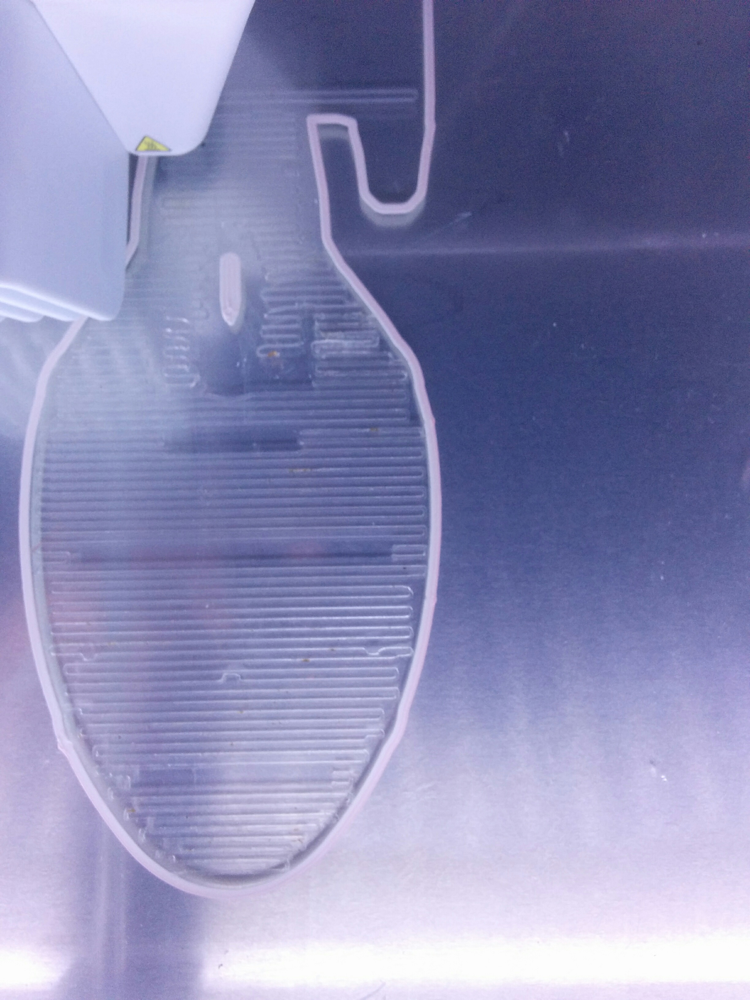

Thanks! I really appreciate any advice you could give - I've got a ton of questions about the UM3 but about getting PVA to stick...
I've tried a lot of different settings for the first layer width/height, speed, cooling, glue, etc. I've had little luck getting the first layer of PVA to stay attached to the build plate, and even if it does the second layer of PVA likely ruins the first!
I've attached an example file of the FFF I most recently used, along with the stl file. A couple of pics of the carnage are also attached.
I've cleaned the extruder/tube multiple times, used lots of glue or hairspray, tried brims and rafts. and varied a lot of parameters with no luck.

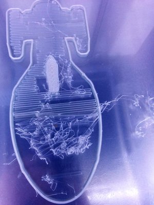

Couldn't upload the pics in previous message due to size.
First layer stays down fairly well...
But second layer get screwed up often, even with a raft.

I just tried it at 40, 35 and 30%, with the same issue. (used http://www.thingiverse.com/thing:378677)
I even took a video (if it ever uploads to google drives I'll share the link). What seems to be happening is that even if the first layer sticks, the second doesn't and tends to come apart. When the second layer fails to stick, it ruins both that layer and makes a stringy mess that makes it impossible to successfully lay down the second layer.
