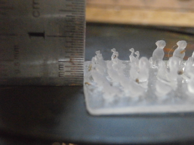

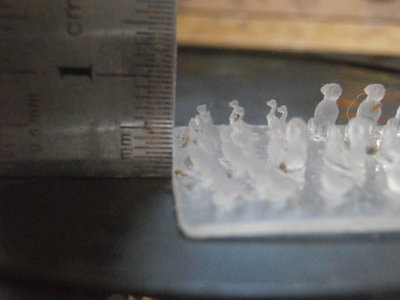

But I have just purchased a CTC Riverside 1.1 printer, and wanted to use S3D.
Currently there is no support for SLA printers, so after contacting S3D support they pointed me in the correct direction, and a bit of fiddling. I am currently using S3d as my slicer for this printer, Works perfectly.
As far as supports go I use the free version of Creation Workshop, export the new STL with the supports and process the new model as normal.
I have attached a copy of my factory file, and a photo of a print with this set up.
Cheers
Tony
S3D PRINT FROM CTC RIVERSIDE
SLA-PRINTER-BASE-FACTORY-S3D.factory
CTC RIVERSIDE FACTORY FILE
(19.99 KiB) Downloaded 582 times

The main thing to make sure of is the bottom of the tray and the sucker touch, this helps to make sure the first layer sticks to the sucker.
One problem this causes is the bottom of the print becomes squashed, so what I do in Creation Workshop is place there build pad then lift my model up about 2mm on supports.
Now the squashed area is below the base of the model, I have had no problems since doing this.
As far as S3D goes what I have set up in the attached factory file is pretty good, maybe the feeds need to be slowed a bit, as I don't think the resin is fully hardened.
I have ordered a uv lite to cure the prints fully, then I can see what I need to do.
I will put some more prints up sometime.
Cheers
Tony
