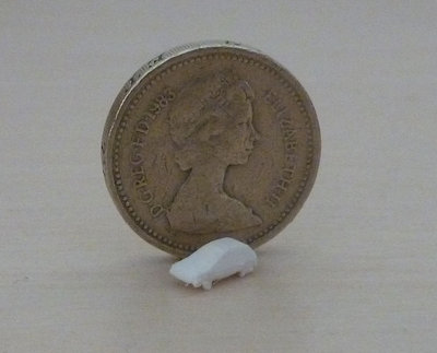

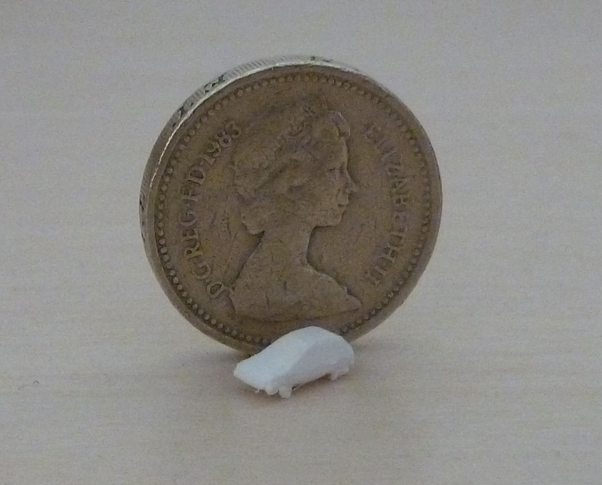

.......and here's why I feel so strongly about getting the issues with thin walls resolved:
A thin wall for everyone else is a really thick wall for me!
btw....that IS a UK pound coin in the photo...which is 1 mm larger in diameter than a 5 cent US coin!
