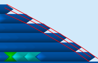

Also, a related question, on the attached image (front view), which red line represents the original STL model? The outer, the middle (average) or the inner? Thanks.
