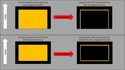

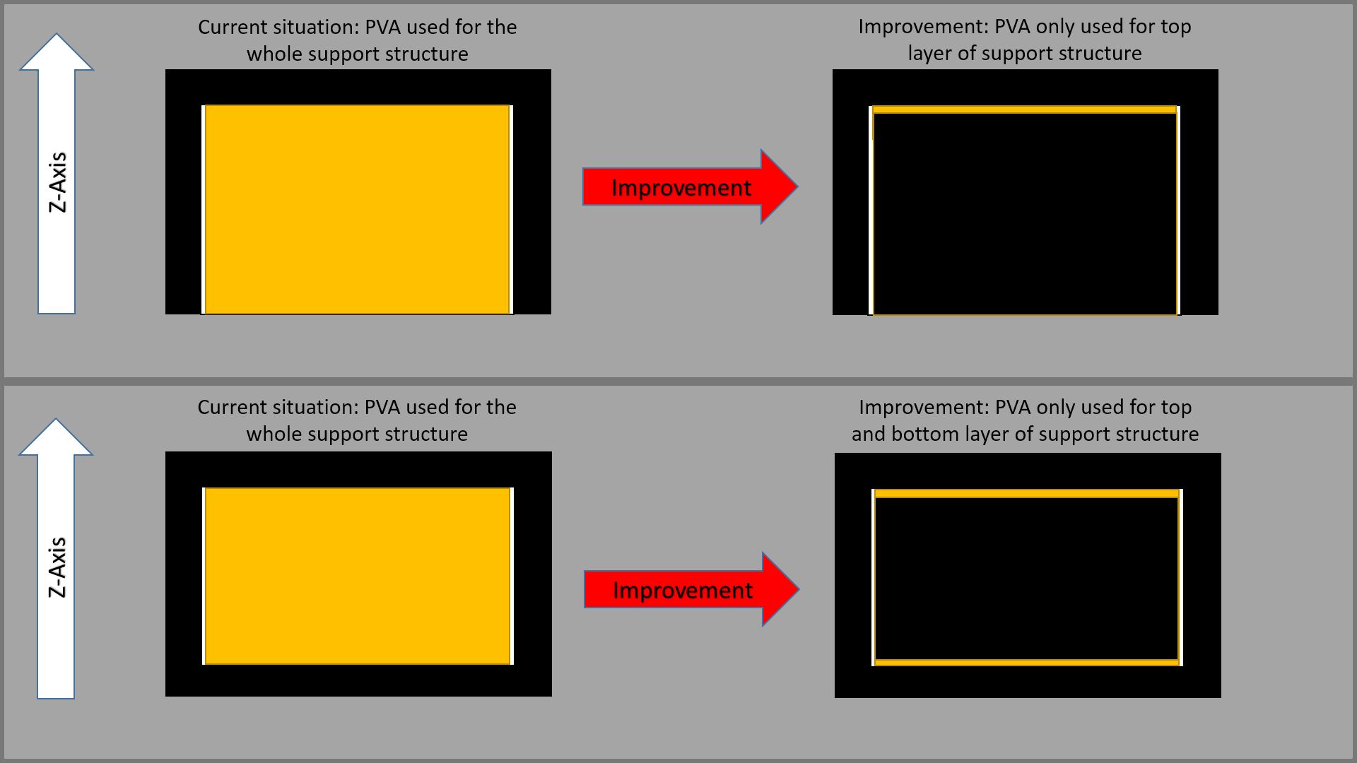

[ADDED] PVA only for top and/or bottom layer of supports
I want to ask for the option to use PVA (or other water soluble filament) only for selectable amount of top and/or bottom layer of the support structure. See my sketch picture attached.
This will have huge improvements:
+ Time: Less printing time due to less extruder change
+ Costs: Reduce amount of required (more expensive) PVA filament
+ Quality: Less PVA/PLA or PVA/ABS pollution for the layers where PVA usage is avoided
Idea concept to reduce amout of needed PVA.

This feature has now been added in Version 4.0. Please see the link below for more information:
viewtopic.php?f=23&t=4921&start=10#p33968
