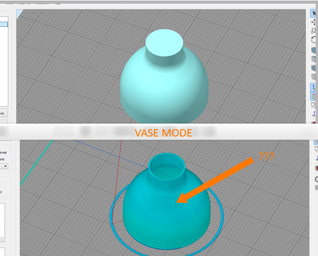

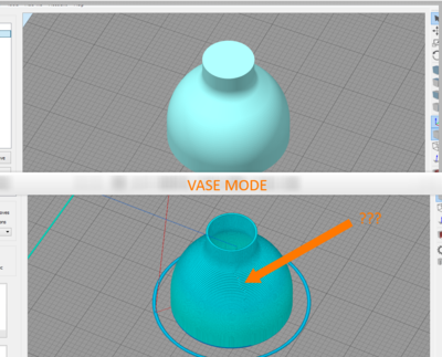

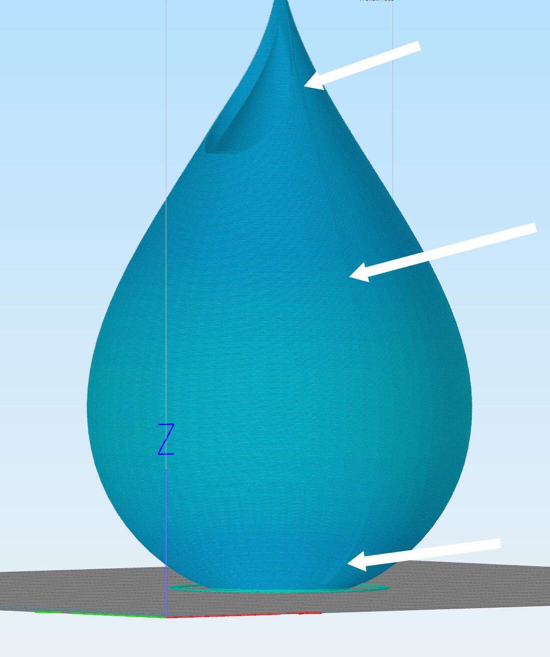

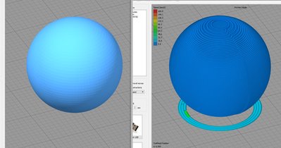

Hey,
is it even possible to print a vase in S3D without a seam on the vase surface?
Never able to print at least one vase without it in S3D. Had to use Slic3r for the vases, and I am not happy with that at all.
PS: model orientation and scale were updated.
vaseTest.stl
(635.73 KiB) Downloaded 384 times

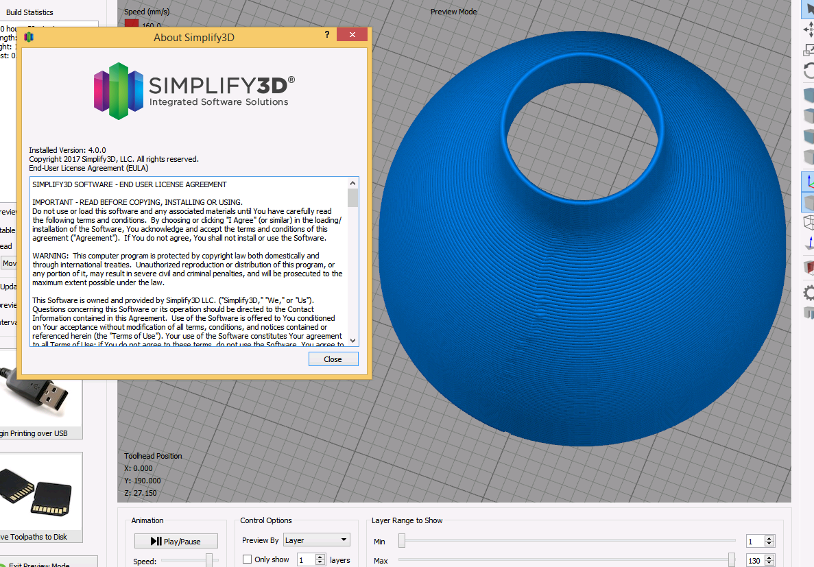

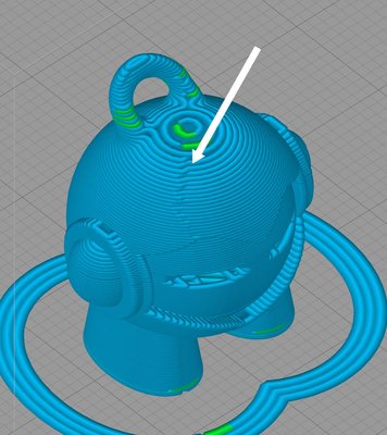

New slicer version - old bugs. Simplify3D 4.0 :( :( :(

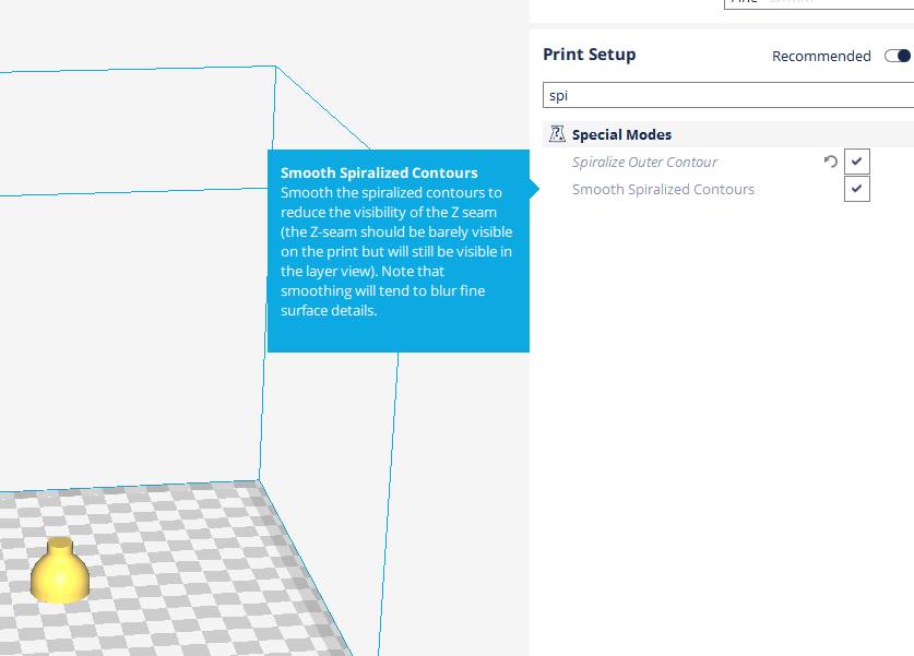

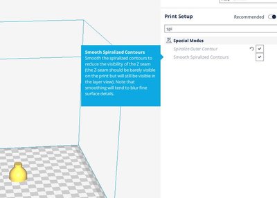

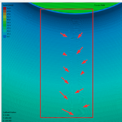

I found, that the Slic3r have the same seam on the models. But the Cura is not. In the Cura you have option to fix it:

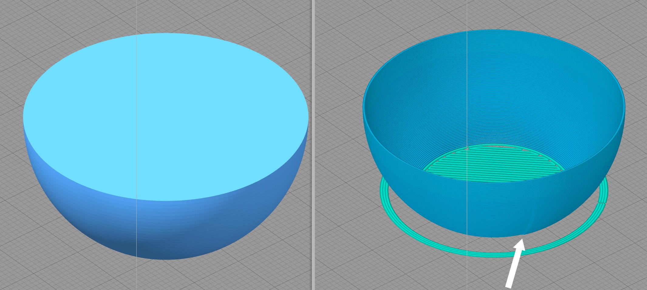

DanceM
Posts: 16
Joined: Sun Aug 07, 2016 7:44 am
Re: Vase mode seam

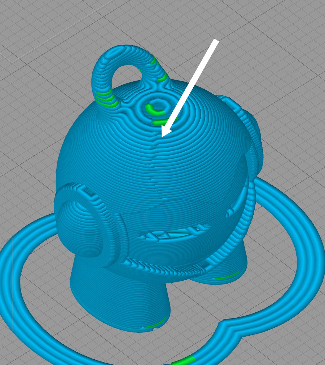

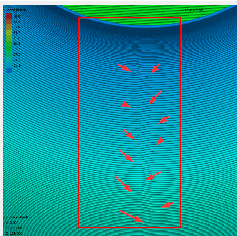

Sorry, my fault, I fixed model orientation and scale.
I did many tests with different models, and this bug is visible on most of them.

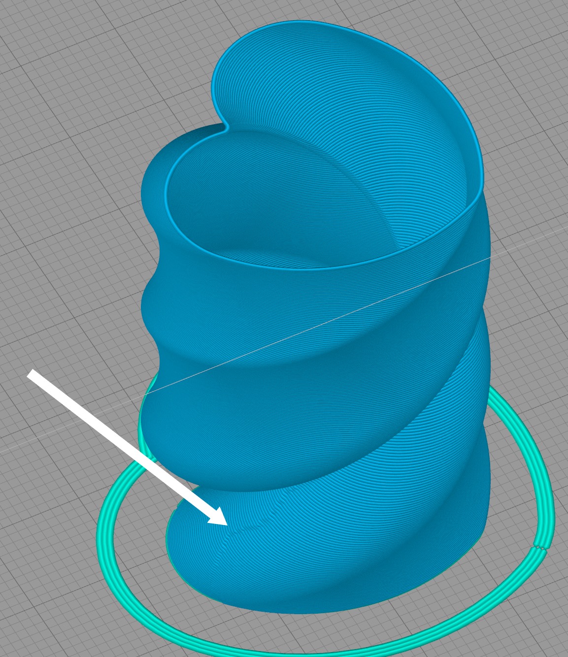

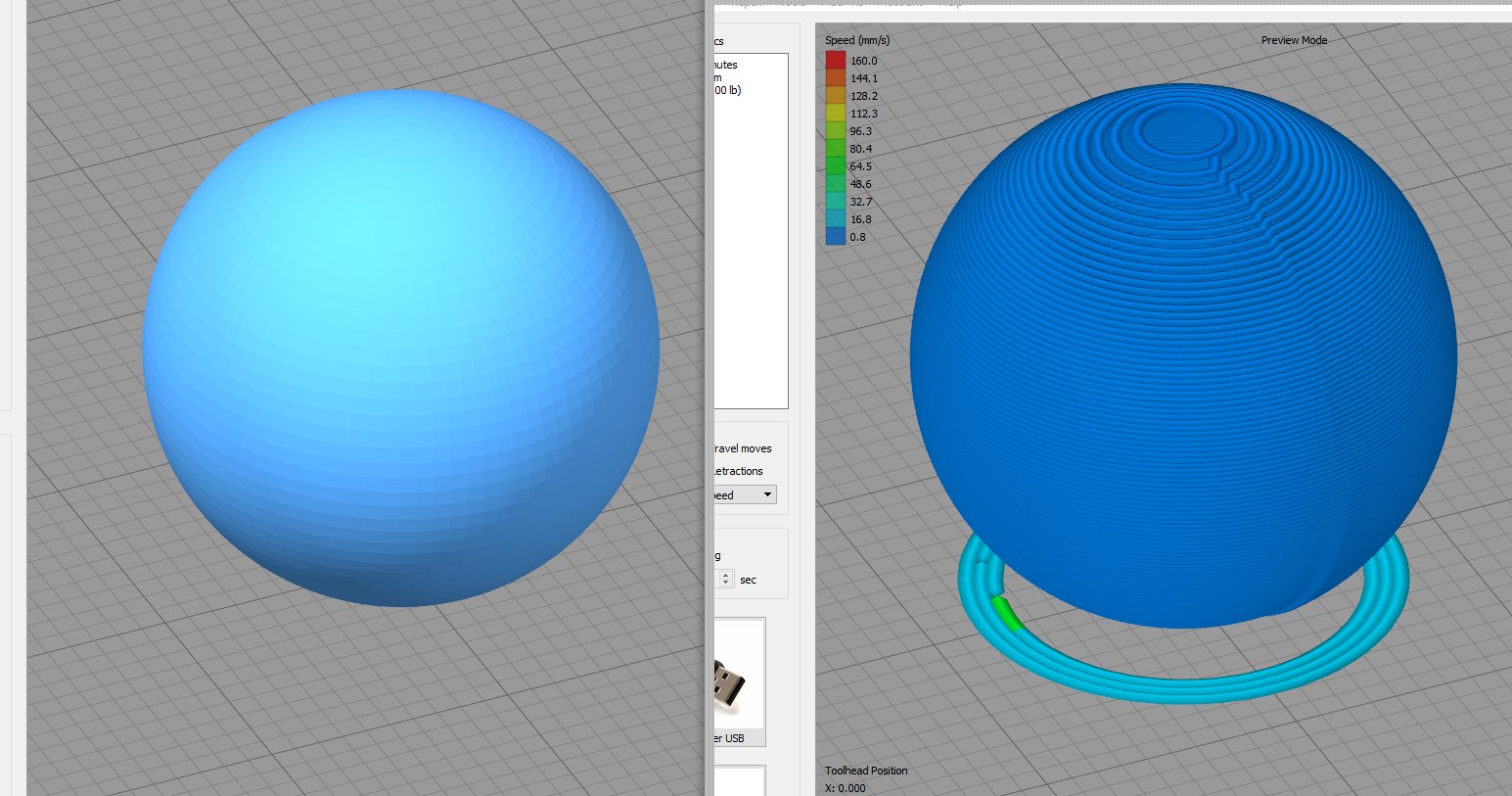

Here are more examples:

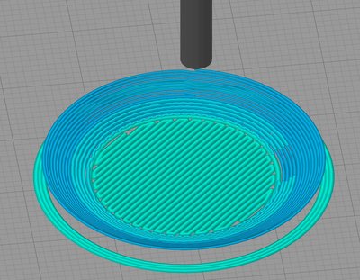

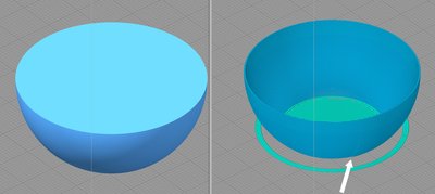

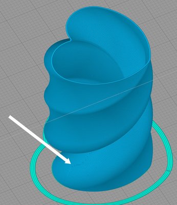

DanceM
Posts: 16
Re: Vase mode seam

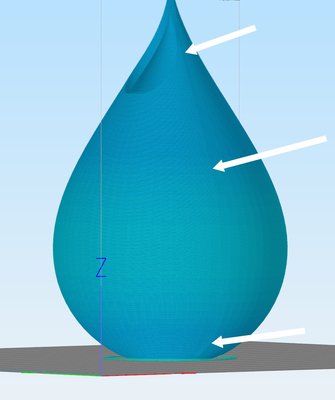

And more:
It is possible to make layer height very small and then the seam is almost not noticible. But if you need to print vase without the seam at all - use Cura, while we have no solution for it in S3D.
