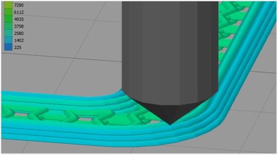

The extruder is coming from the left, just about to finish the outer bead (G-code Line 265441). You can see the red retraction where it had lifted up & then set down before starting the bead:

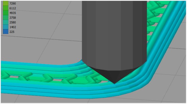

Next, it completes the loop at normal speed (G-Code Lines 265442-265444):

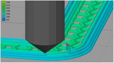

Here's where it picks up speed, and appears to lay down another bead on top of the existing one (Lines 265445-265449):
This is exactly where I get a blob on the actual print. It starts out big & fades out as it goes around the corner, and you can see in the preview that the extrusion has shrunk to a thin line before it goes off elsewhere. (too bad I'm limited to three images...)
