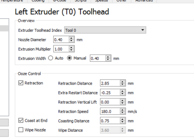

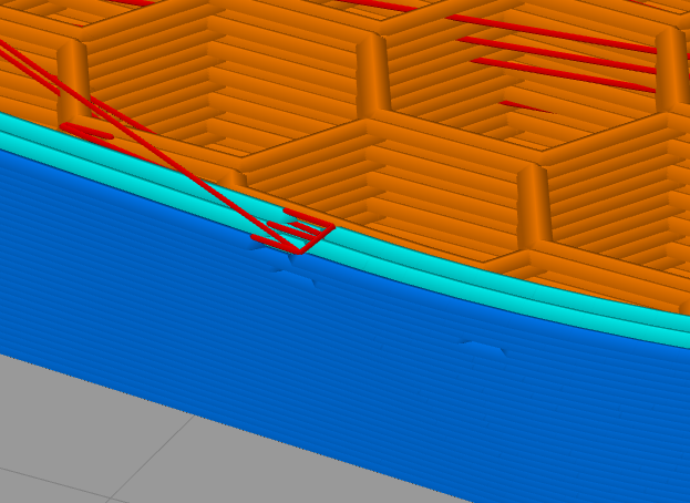

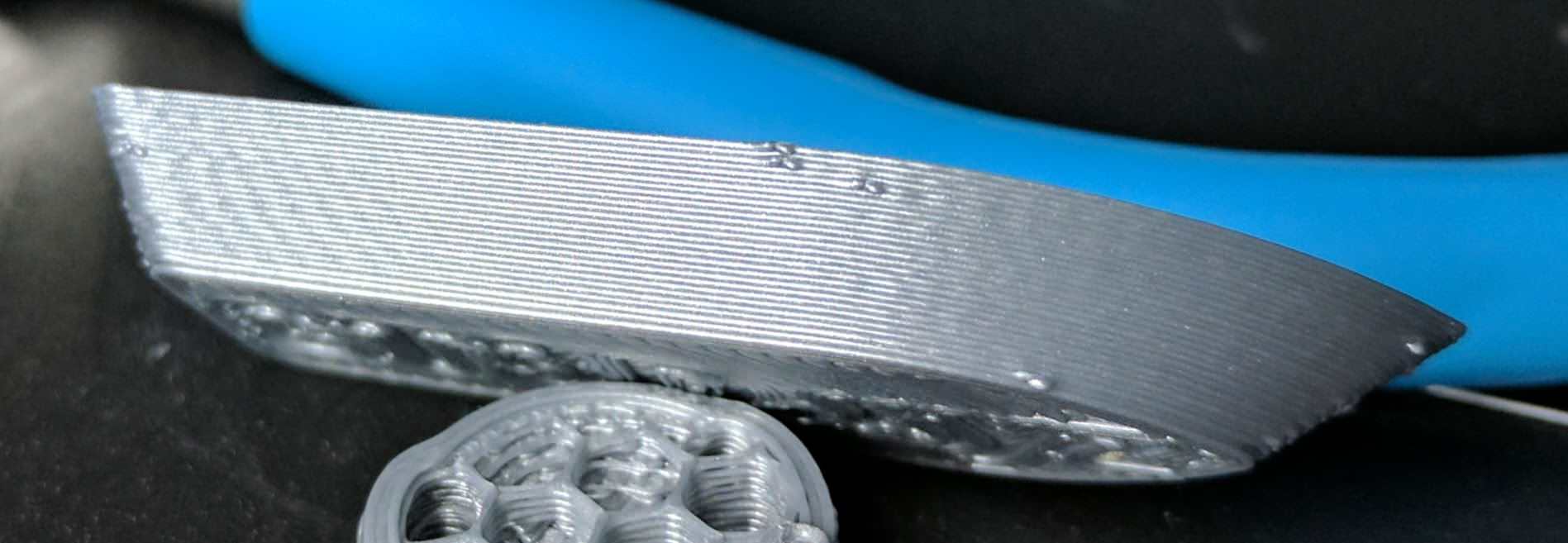

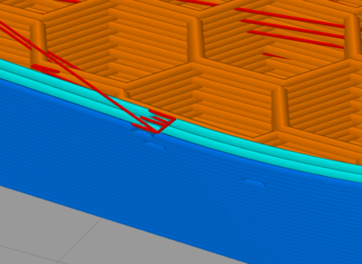

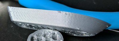

Hopefully this is in the right forum location. I am having trouble getting the last bit of surface quality dialed in. First, I know I can line seams up at a given location etc, but I'd prefer to solve this little visual artifact.
All of my print settings are included in the album as well as the pictures of the model and problem: http://imgur.com/a/7ldfu
Essentially, what is happening appears to be related to travels from the inner to outer perimeter (and based on prints after this album, occurs on outer to inner as well).
This occurs when I have print outer to inner, or inner to outer. It happens with only retract over open spaces, it doesnt seem to change when I doubled coasting, or nearly doubled my negative extra restart distance. The screenshots are of a version with retractions on inner perimeters, but even on versions without inner perimeters, this occurs.

Well it looks like you are still getting extra plastic at those start points for each loop, so I would keep increasing the coasting distance or make the extra restart distance a larger negative number until the extra plastic goes away. If you keep increasing those values, you would eventually get holes in the print instead of extra plastic. So then you can adjust them until you find the sweet spot.

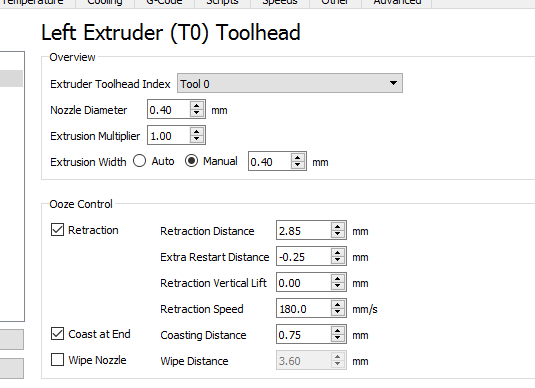

I've tried quite a few variations on coasting/wiping/retraction/extra restart distance. I have one going now with much higher coast and extra restart distance, I'll post my pictures and settings when I get home.
